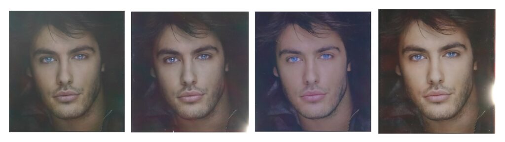

Readability evaluates the ease and comfort with which users can read the still content (photos and web) on the display under various real-life conditions. SBMARK uses its Display Bench to recreate ambient light conditions ranging from total darkness to bright sunlight. In addition to laboratory tests, perceptual analysis is also performed in real-life environments.
From left to right: Asus ROG Phone 6, Asus ROG Phone 5, Poco F4 GT, Samsung Galaxy S22 Ultra (Snapdragon)
Readability in a sunlight environment (>90 0000 lux).

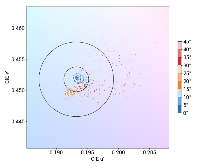

Color behavior on the corner
This graph shows the color shift when the screen is tilted. Each point represents a measurement at a particular angle. The dots within the inner circle show no color change in the corner; those between the inner and outer circle have shifts that only trained experts will see; but those which fall outside the outer circle are evident.

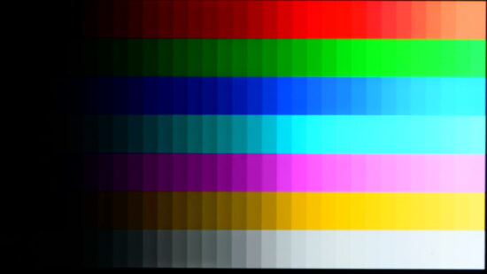

Primary colors are measured in both HDR10 and SDR. The extracted color gamut shows the extent of color area that the device can render. To meet artistic intent, the measured gamut should match the primary color space of each video.
HDR10 gamut measurements were performed using 80% red, green, and blue test patterns. In fact, heavy desaturation was measured using our usual 100% red, green, and blue patterns, leading to severely reduced gamma.
This photo shows the Asus ROG Phone 6’s HDR10 color levels being over 80% desaturated.

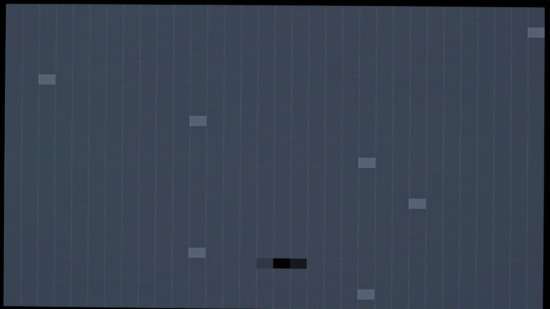

The video frame drops
These long exposure photos feature the number of frame irregularities in a 30 second video. Good performance shows a regular pattern (a flat gray image or a pull-down pattern).

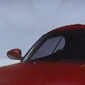

Evaluating artifacts means checking performance, image rendering, and motion artifacts that can impact the end-user experience. SBMARK accurately measures device reflectance and flicker, and evaluates the impact of residual aliasing when playing video games, among other characteristics.
Aliasing (foreground)
Asus ROG Phone 6
Asus ROG Phone 6 – Crop 1
Asus ROG Phone 6 – Crop 2
Asus ROG Phone 6 – Crop 3
