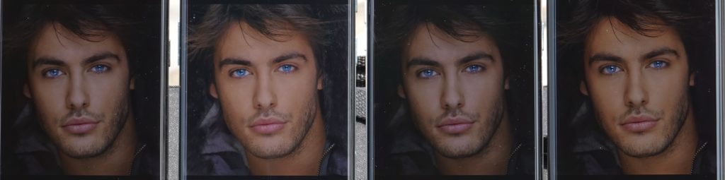

In low light conditions, the OnePlus 10 Pro’s brightness is slightly low. Note that the device changes its brightness levels depending on the time of day. SBMARK performs object measurements in daylight conditions and the brightness of the 10 Pro is accordingly quite high. However, we run our perceptual tests in midnight (0 lux) conditions, and as shown in the illustration below, the 10 Pro is indeed weaker than its competitors.

The OnePlus 10 Pro lacks brightness outdoors, but its brightness level outdoors in the shade is better than that of its predecessor, the OnePlus 9 Pro, as can be seen in the illustration below.

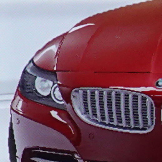

However, unlike the OnePlus 9 Pro in the illustration below, the 10 Pro’s content loses a lot of detail in the darker areas when viewed in sunlight.

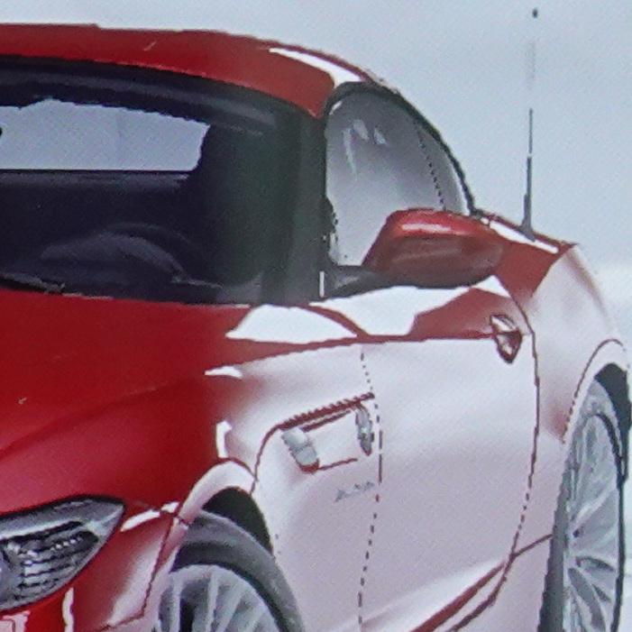

The OnePlus 10 Pro also lacks brightness when viewed at an angle, as shown below.

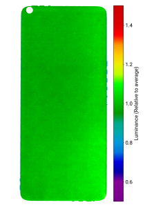

OnePlus 10 Pro has excellent brightness uniformity.
This graph shows the uniformity of the display using a 20% gray pattern. The more green the color is visible, the smoother the display.

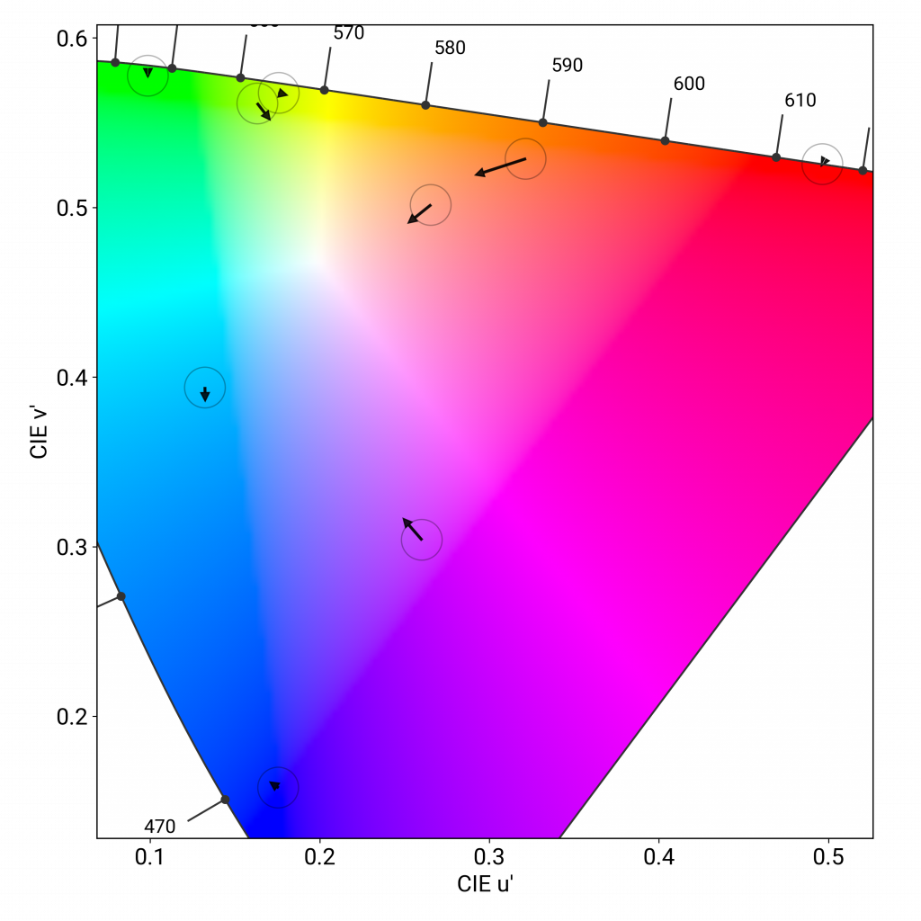

The OnePlus 10 Pro has particularly good color fidelity in the DCI-P3 color space.
Color fidelity measurements
OnePlus 10 Pro, color fidelity at 1000 lux in the sRGB color space
OnePlus 10 Pro, color fidelity at 1000 lux in the DCI-P3 color space
Each arrow represents the color difference between a target color model (arrow base) and its actual measurement (arrowhead). The longer the arrow, the more visible the color difference. If the arrow stays inside the circle, the color difference will only be visible to trained eyes.

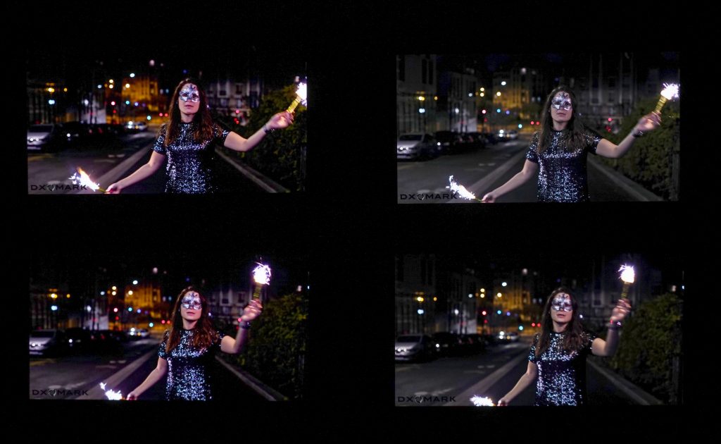

The OnePlus 10 Pro performed poorly in our video attributes tests, falling far behind the leaders in its category. HDR10 videos played on the device lack brightness and are too contrasty; furthermore, dark tones are barely visible, making the viewing experience less than optimal.
Clockwise from top left: OnePlus 10 Pro, OnePlus 9 Pro, Google Pixel 6 Pro, Oppo Find X5 Pro
The colors of the video are excessively saturated and show an orange cast; on a positive note, however, the cast does not affect skin tone rendering.
Video color rendering in a low light environment (0 lux).

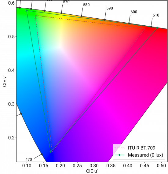

Range coverage for video content
Primary colors are measured in both HDR10 and SDR. The extracted color gamut shows the extent of the color area that the device can render. To respect the artistic intent, the measured gamut should match the main color space of each video.

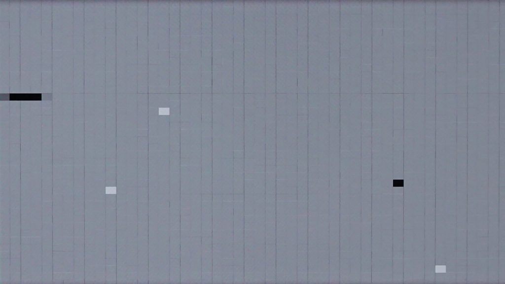

The OnePlus 10 Pro shows some frame mismatches for 30fps and 60fps content, but when playing video games, no frame discrepancies are visible. Motion blur is well managed. The device shows a delay before resuming video playback.
The video frame drops
OnePlus 10 Pro content at 30 fps
These long exposure photos present the number of frame irregularities in a 30 second video. A good performance shows a regular pattern (a flat gray image or a drop-down pattern).
