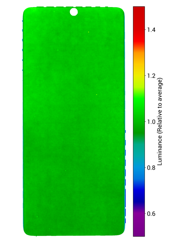

- The display is uniform in brightness and color

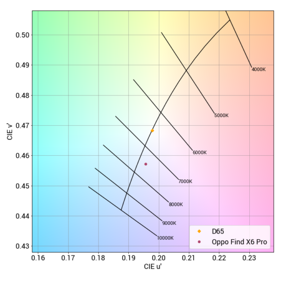

The color attribute evaluates the device’s ability to faithfully reproduce colors. Measurements taken include fidelity, white point color, and gamut coverage. We perform color assessments for different lighting conditions to see how well the device can handle color in its surroundings. Colors are measured using a spectrophotometer in a controlled lighting environment. The perceptual analysis of the color rendering compares with the reference model displayed on a calibrated professional monitor.
Clockwise from top left: Oppo Find X6 Pro, Huawei P60 Pro, Samsung Galaxy S23 Ultra, Apple iPhone 14 Pro Max

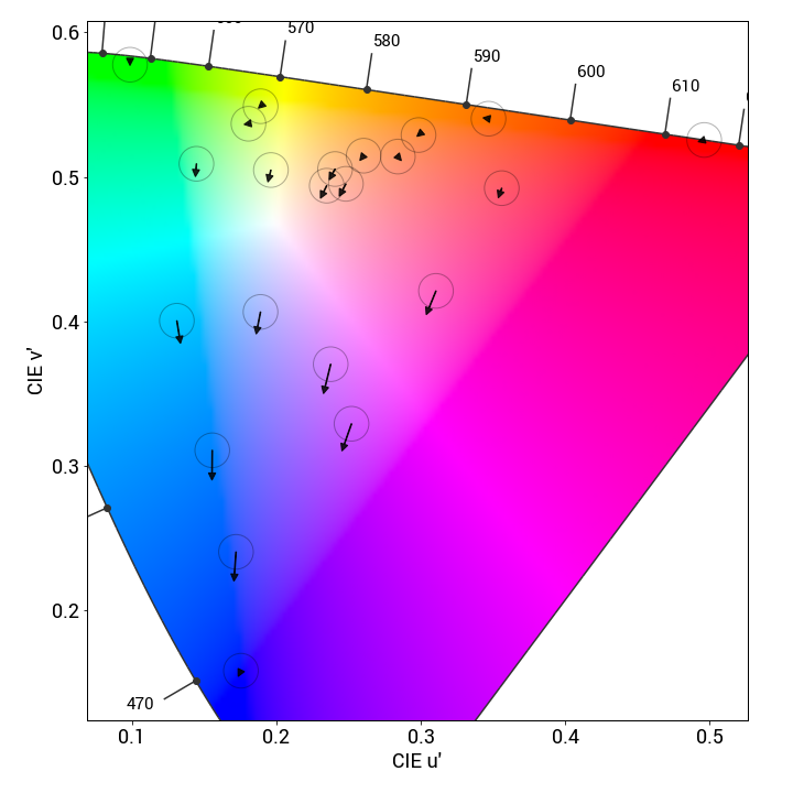

Color fidelity measurements
Oppo Find X6 Pro, color fidelity at 1000 lux in the sRGB color space
Oppo Find X6 Pro, color fidelity at 1000 lux in Display-P3 color space
Each arrow represents the color difference between a target color pattern (arrow base) and its actual measurement (arrow tip). The longer the arrow, the more visible the color difference. If the arrow stays inside the circle, the color difference will only be visible to trained eyes.

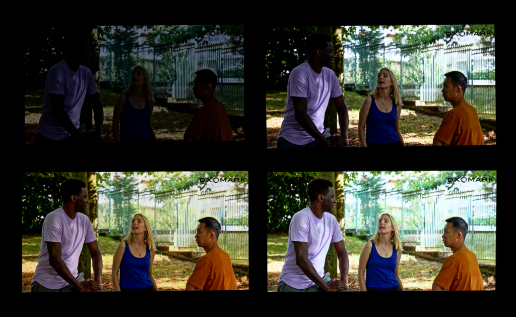

Our video attribute evaluates each device’s Standard Dynamic Range (SDR) and High Dynamic Range (HDR10) video handling in indoor and low-light conditions. We measure the tone mapping, color gamut, brightness and contrast of the display. We perform perceptual analysis Cons our professional reference monitor (Sony BVM-HX310) to ensure rendering respects artistic intent.

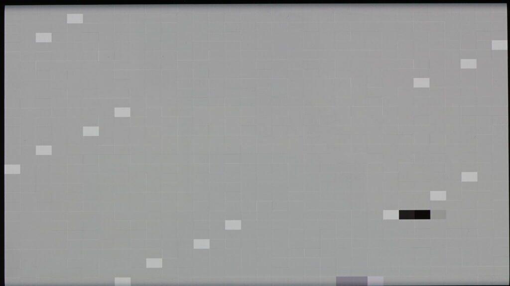

The motion attribute evaluates the handling of dynamic content. Frame drops, motion blur, and playback artifacts are examined using games and videos.
The video frame drops
These long exposure photos feature the number of frame irregularities in a 30 second video. Good performance shows a regular pattern (a flat gray image or a pull-down pattern).
