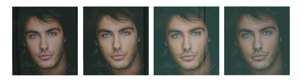

Left to right: Google Pixel 6a, Google Pixel 6, Samsung A53 5G, Oppo Find X5 Lite
Readability in a sunlight environment (> 90 0000 lux).

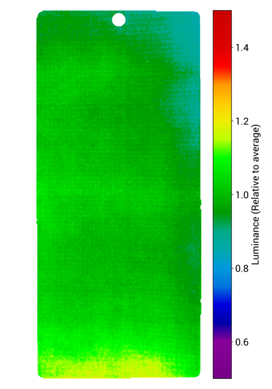

This graph shows the uniformity of the display with a gray pattern of 20%. The more green the color is visible, the smoother the display.

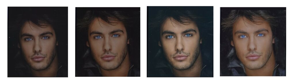

Our video attribute evaluates the Standard Dynamic Range (SDR) and High Dynamic Range (HDR10) video handling of each device indoors and in low-light conditions. We measure the tone mapping, color gamut, brightness and contrast of the display. We perform perceptual analysis Cons our professional reference monitor (Sony BVM-HX310) to ensure that the rendering respects the artistic intent.
Clockwise from top left: Google Pixel 6a, Google Pixel 6, Oppo Find X5 Lite (Samsung Galaxy A53 5G cannot read HDR10 content.)
