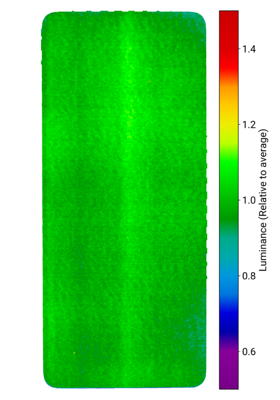

This graph shows the uniformity of the display with a gray pattern of 20%. The more green the color is visible, the smoother the display.

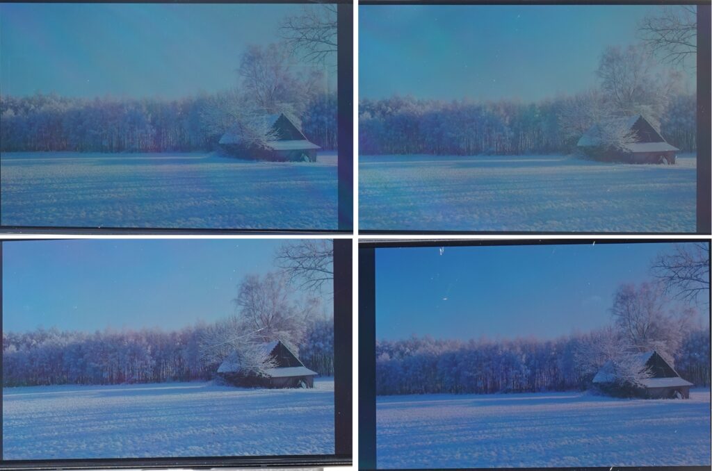

White point under illuminant D65 at 1000 lux
Clockwise from top left: Lenovo Legion Y90, Lenovo Legion Phone 2 Pro, Motorola Edge 30 Pro, Asus ROG Phone 5

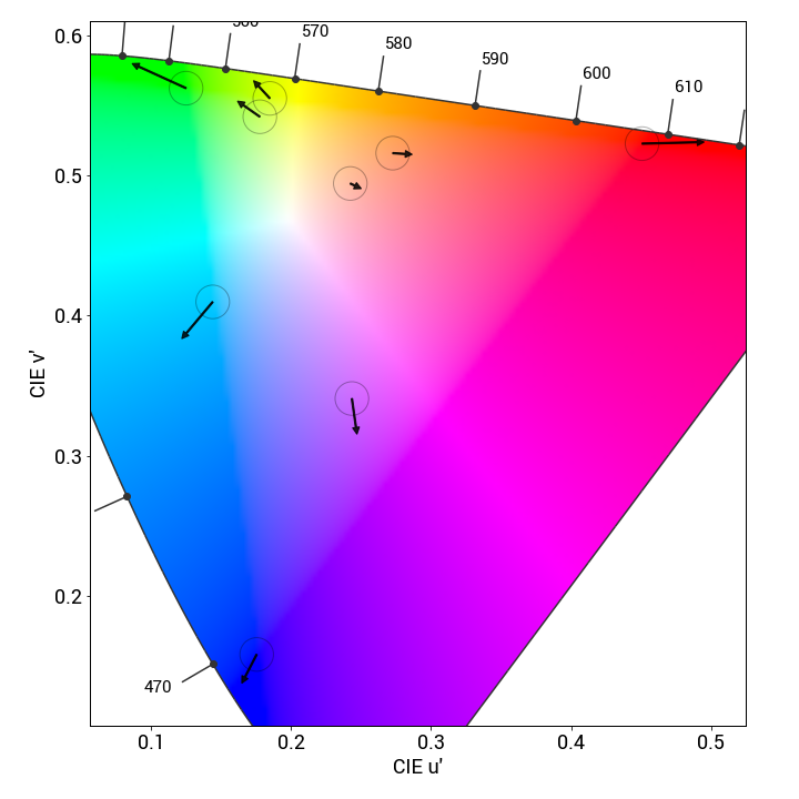

Color fidelity measurements
Lenovo Legion Y90, 1000 lux color fidelity in the sRGB color space
Lenovo Legion Y90, 1000 lux color fidelity in the DCI-P3 color space
Each arrow represents the color difference between a target color model (arrow base) and its actual measurement (arrowhead). The longer the arrow, the more visible the color difference. If the arrow stays inside the circle, the color difference will only be visible to trained eyes.

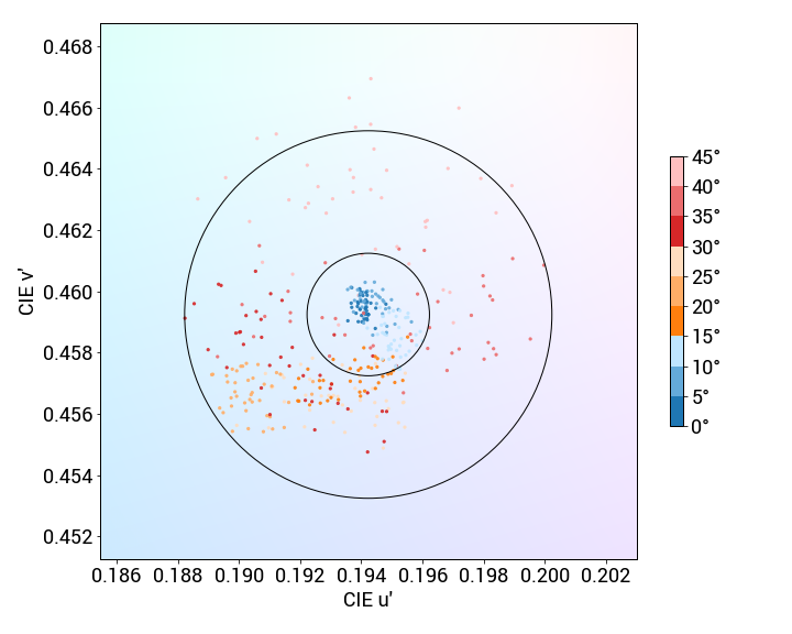

Behavior of the color on the corner
This graph shows the shift of color when the screen is tilted. Each point represents a measurement with a particular angle. The points inside the inner circle show no color change in the corner; those between the inner and outer circle have shifts that only trained experts will see; but those who fall outside the outer circle are noted.

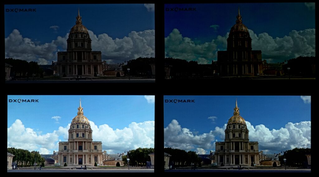

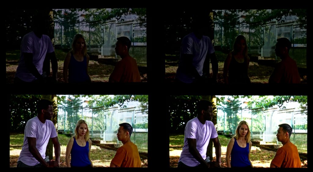

Our video attribute evaluates the Standard Dynamic Range (SDR) and High Dynamic Range (HDR10) video handling of each device indoors and in low light conditions. We measure the tone mapping, color gamut, brightness and contrast of the display. We perform perceptual analysis Cons our professional reference monitor (Sony BVM-HX310) to ensure that the rendering respects the artistic intent.

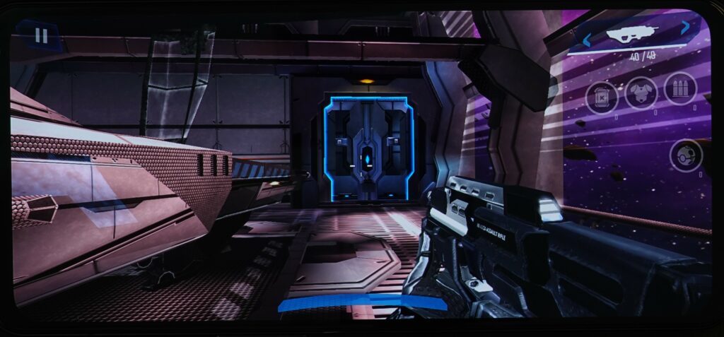

Evaluating artifacts means checking performance, image rendering, and motion defects that can affect the end-user experience. SBMARK accurately measures device reflectance and flickering and evaluates the impact of residual aliasing when playing video games, among other characteristics.
The measurements above show the reflection of the device within the visible spectrum range (400nm to 700nm). It includes both diffuse and specular reflection.
This graph represents the variation frequencies of the illumination; the highest peak gives the main flicker frequency.

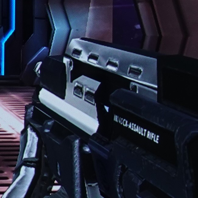

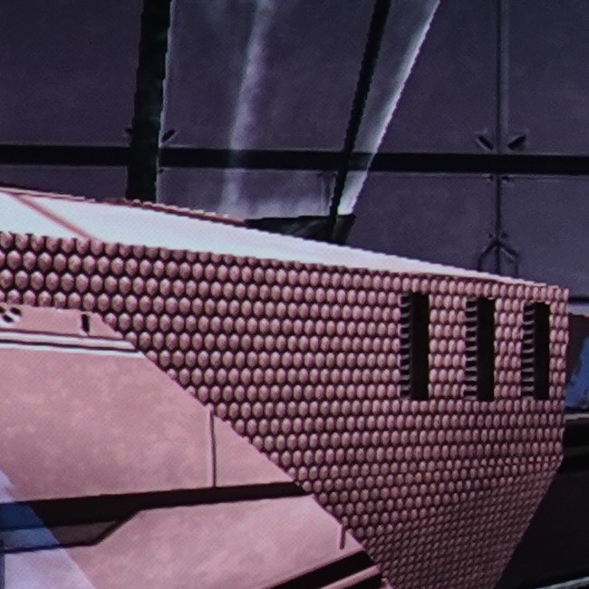

Alias ​​(foreground)
Lenovo Legion Y90 – Crop1
Lenovo Legion Y90 – Harvest 2
Lenovo Legion Y90 – Crop3
