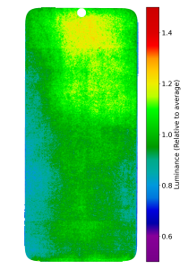

False color luminance uniformity for 20% gray
This graph shows the uniformity of the display with a 20% gray model.
More visibleand the the green color is, the more aImodule is the display.

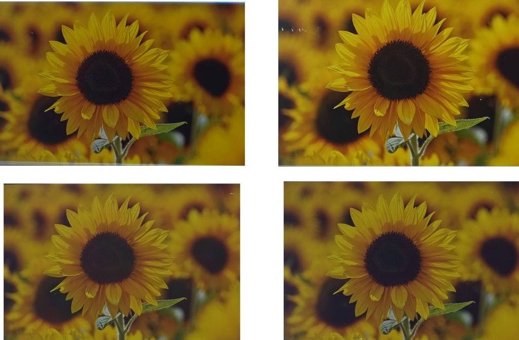

Color rendering outdoors, clockwise from top left: Xiaomi 12, Xiaomi 11 Ultra, the Apple iPhone 13 and the Asus Zenfone 8.
The Xiaomi 12 shows a slight blue to green cast.

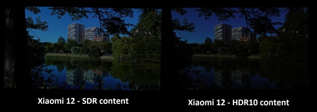

Our video attribute evaluates the Standard Dynamic Range (SDR) and High Dynamic Range (HDR10) video handling of each device indoors and in low light conditions. We measure the tone mapping, color gamut, brightness and contrast of the display. We perform perceptual analysis Cons our professional reference monitor (Sony BVM-HX310) to ensure that the rendering respects the artistic intent.
The brightness of the device is low for HDR10 content.

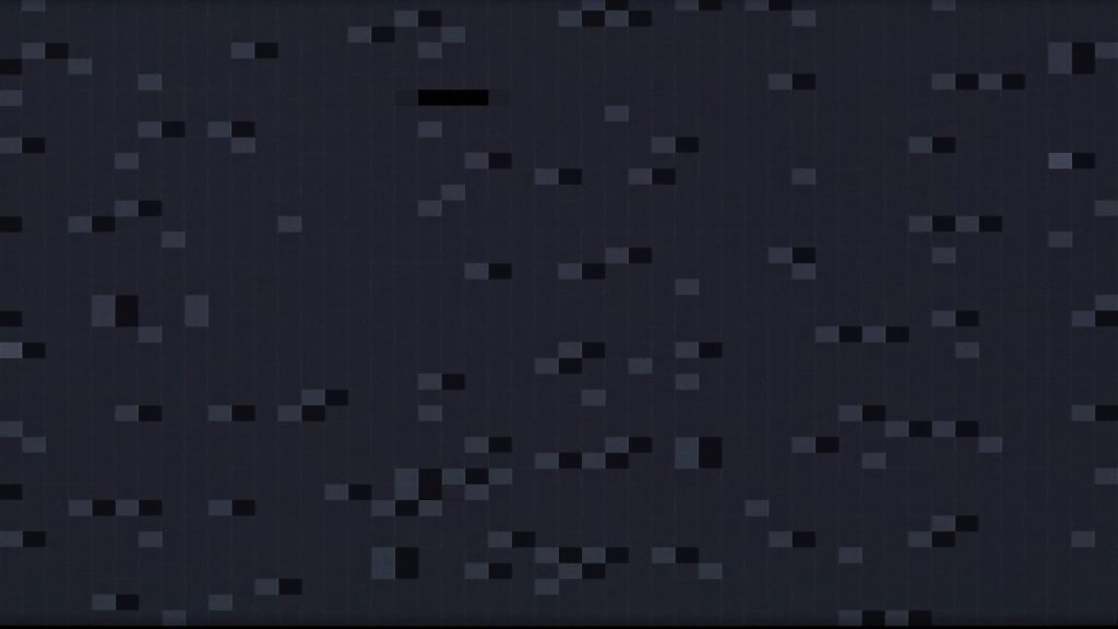

The long exposure photos below show the number of frame irregularities in a 30-second video. A good performance shows a regular pattern (a flat gray image or a drop-down pattern).
Xiaomi 12, frame drops to 30 fps
Xiaomi 12, frame drops to 60 fps
