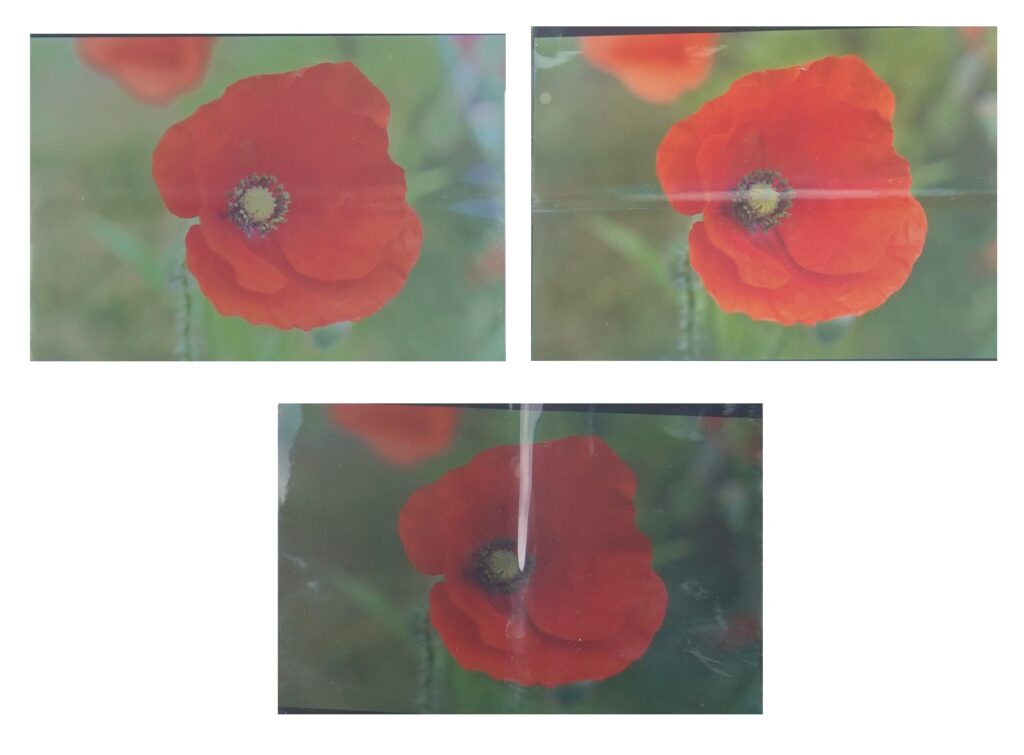

From left to right: Xiaomi Mix Fold 3, Samsung Galaxy Z Fold5, Google Pixel Fold

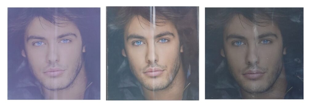

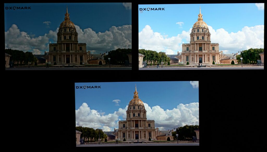

Clockwise from top left: Xiaomi Mix Fold 3, Samsung Galaxy Z Fold5, Google Pixel Fold

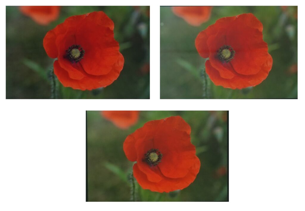

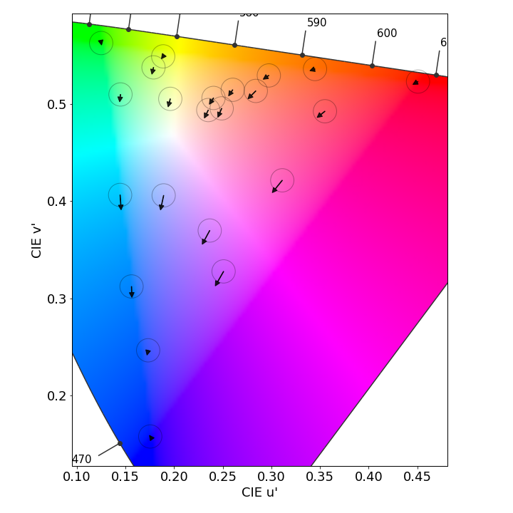

Color fidelity measurements
Xiaomi Mix Fold 3, color fidelity at 1000 lux in the sRGB color space
Xiaomi Mix Fold 3, color fidelity at 1000 lux in the Display-P3 color space

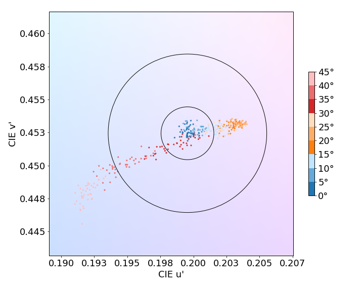

Color behavior on the corner

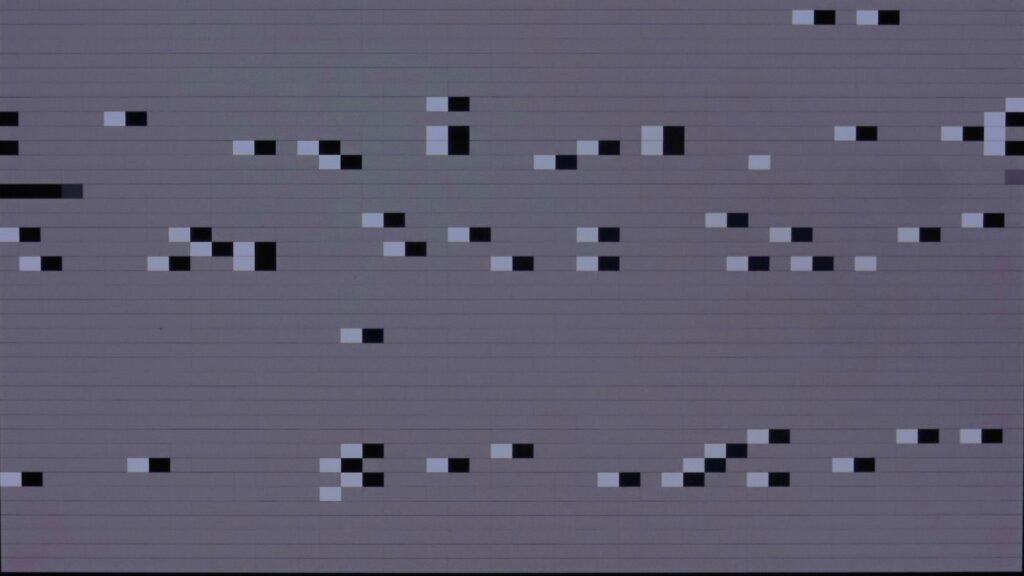

Dropped video frames

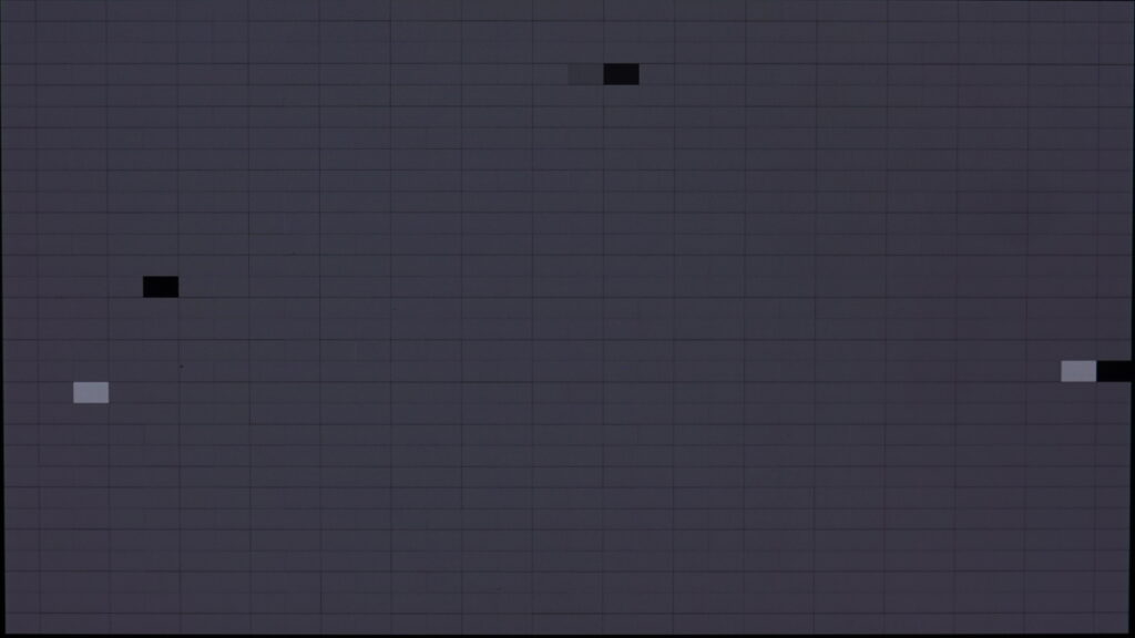

To evaluate touch, SBMARK uses a touch robot and a high-speed camera to play and record a series of scenarios for evaluating smoothness, accuracy and response time.
