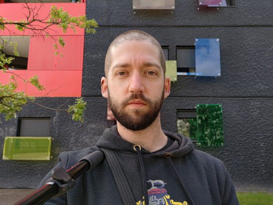

These samples show the exposure performance of the Huawei P50 Pro in an outdoor scene.
Huawei P50 Pro, precise target exposure, wide dynamic range
Huawei Mate 40 Pro, precise target exposure, slightly lower dynamic range
Asus Zenfone 7 Pro, limited dynamic range, highlight clipping

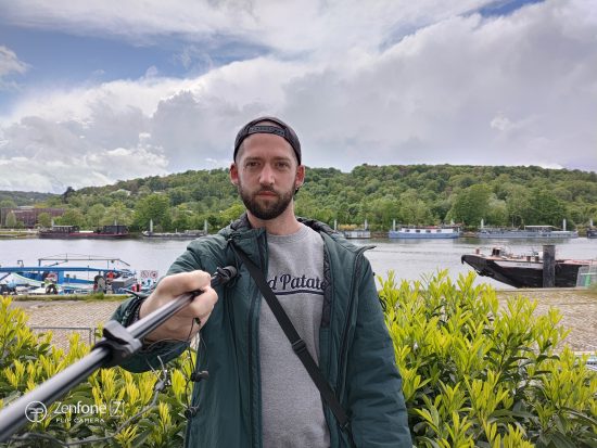

These samples show the focus performance of the Huawei P50 Pro in daylight.
Huawei P50 Pro, shallow depth of field
Huawei P50 Pro, crop: very precise focus, large depth of field, good detail in the background
Huawei Mate 40 Pro, shallow depth of field
Huawei Mate 40 Pro, crop: stable focus (fixed focus), lack of background detail
Asus Zenfone 7 Pro, shallow depth of field
Asus Zenfone 7 Pro, crop: stable autofocus, shallow depth of field and lack of background detail

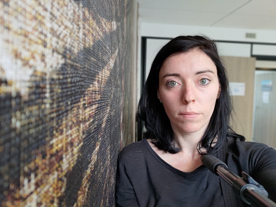

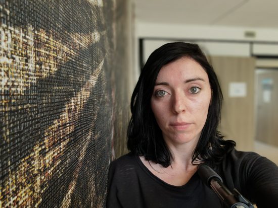

This example shows unnatural texture artifacts in low light conditions.
Huawei P50 Pro, artifacts
Huawei P50 Pro, crop: unnatural rendering of textures on skin and facial hair

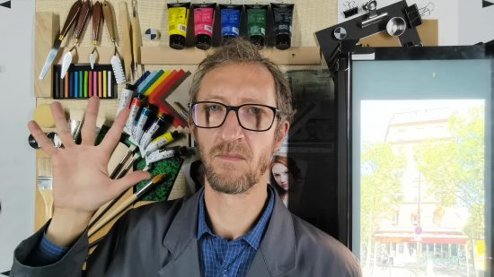

Exposure tests evaluate facial brightness and dynamic range, eg. the ability to make details visible in both light and dark areas of the image. The stability and temporal adaptation of exposure are also analyzed. Image quality color analysis examines skin tone rendition, white balance, color shading, white balance stability, and its adaptation when the light changes.
These video images show the video exposure performance of the Huawei P50 Pro in indoor light conditions.
Huawei P50 Pro, still video, good exposure and wide dynamic range even in this challenging backlit scene
Huawei Mate 40 Pro, still video, occasional underexposure in high contrast scenes
