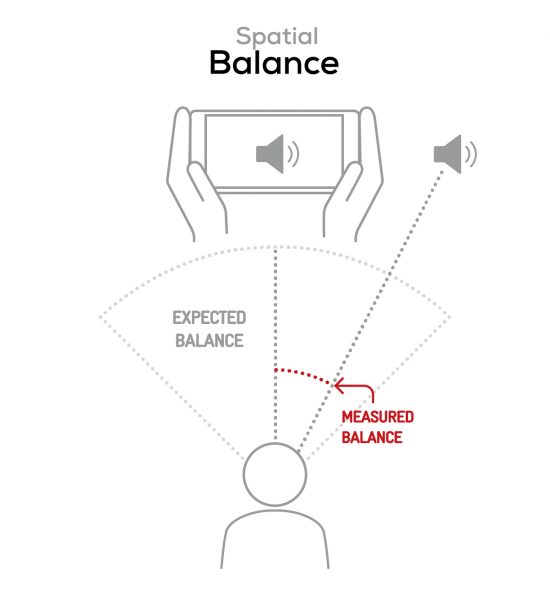

Secondary attributes for spatial tests include identifying the position of a specific sound, its positional balance, distance and amplitude.
The Google Pixel 6 Pro gets a below-average spatial under-score due to its rather tight and heavily unbalanced stereo scene, which is noticeably shifted to the right side of the device (in landscape mode), except when gaming! Note that this imbalance is modifiable in the settings menu at a great price: the left side becomes harmonically very rich, while the right side sounds almost empty. It goes without saying that the result also sounds very asymmetrical, but in a different way. Also, the orientation of the audio only follows the rotation of the phone when watching a movie, not when playing music.
The rendering of the distance is realistic (especially in films, where the voices are particularly early, therefore very intelligible) and the localizability of the sound sources within the field is quite precise. In terms of use cases, the games are doing better and, by far, thanks to the excellent localizability, balance and breadth.
