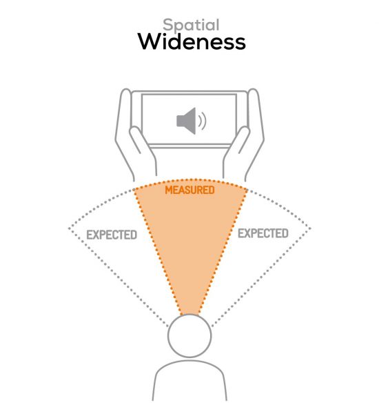

In the Space category the X80 Pro has average performance. The stereo is mostly centered but given the overall size of the phone the width could be better. A lack of clarity means that the distance rendering could be better and while the sound sources are fairly easy to spot in the scene, the positioning isn’t very accurate. The minimum volume of the device is adequate, low but not too low, but the maximum volume is held back by dynamic processing and the consistency between the volume levels could be better. The X80 Pro performs quite well in terms of artifacts. Our testers didn’t notice much distortion or loud pumping, but dynamic processing can involve compression or volume jumps at any volume level.

Secondary attributes for spatial tests include identifying the position of a specific sound, its positional balance, distance and amplitude.
