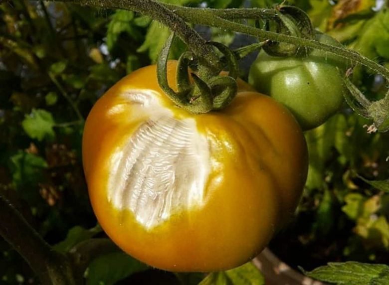

There blanching of tomatoes is a very common pathophysiology in the cultivation of this plant. This is a very noticeable damage on the skin. It is caused by excessive sun exposure, associated with high temperatures. It typically occurs in the hottest weeks of the year, in the months of July and August, when the tomatoes are ripening. Another very common situation of sunburn is in greenhouse cultivation, where it is easier for high temperatures to be reached in periods of strong sunshine. But why does this sunburn happen? Behind this problem there may be incorrect cultivation practices. So let’s see what to do to prevent the tomato fruits from spoiling.
How is the blanching of tomatoes manifested
The sunburn of the tomatoes is due to the direct exposure of the bunches to sunlight. In the fruit tissues the inhibition of the synthesis of lycopene, a natural mechanism that gives us the normal coloring of the berries. The internal temperature of the fruit rises excessively and the tissues are damaged. On the most exposed façade a whitish depressed area is created, with a leathery consistency, almost shining. The affected area sinks more and more and it is easy for black molds to form in this point. Sunburn usually occurs when tomatoes are still green and ripening. However, it can also occur on already orange-red fruits. This type of problem is also common on another crop, namely i peppers.
