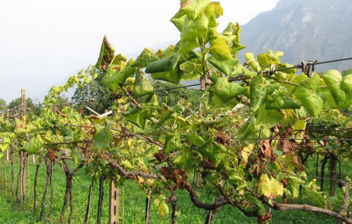

The symptoms of flavescence dorée affect the clusters, leaves and shoots, here are the main ones:
- sudden stop of vegetative activity, with some buds remaining closed;

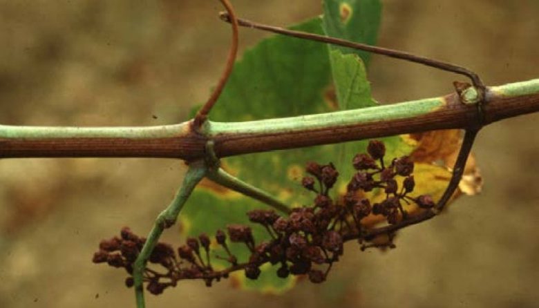

- in early manifestations the inflorescences or bunches dry up and then fall off;
- lack of swelling of the bunch in which berries tend to shrivel and then dry out (in July-August this is an important sign of the disease);

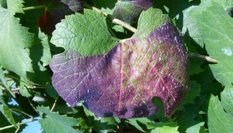

- the leaves show a vitreous fracture and marked triangular rolling of the lamina towards the underside, with a color tending to yellowish in the white grapes, to red-purple in the black grapes. Often on the leaves appear color breaks with red or yellowish spots on the green limb, furthermore the leaf plate is thickened and tends to detach from the petiole;
- the shoots show difficulty in lignification and a rubbery consistency. They tend to bend downward, giving the plant a prostrate appearance. At the base there are lesions and black and oily pustules arranged in linear rows. These parts can dry out and blacken in winter.
- On the leaves
- On the bunches
- On the branches
