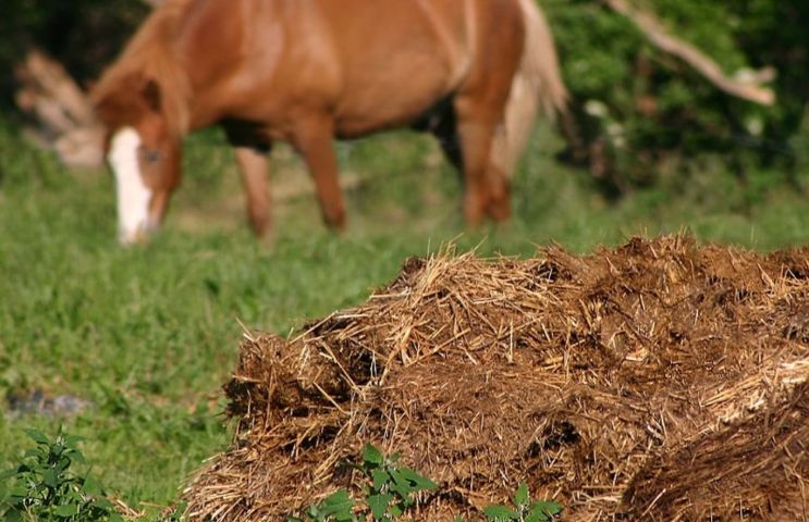

Cow manure is probably easier to find, but it must be said that it is the poorest in organic matter and elements.
Sheep
Sheep manure is excellent in terms of composition. In the areas where sheep and goats are raised, it is not difficult to find organic livestock farms, which will gladly sell you a good product.
Equine
Horse manure is probably the most practical solution. There are many riding schools in our countryside, where animals are raised correctly. Usually, those who do horse riding do not practice intensive horticulture, so it is easier to find excellent horse manure.

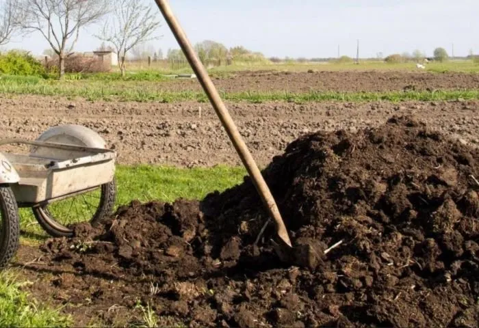

Another problem is that of the distribution of manure on the ground, which must be as uniform as possible.
If the fertilizer spreader brought by the tractor is used on large plots, in a small vegetable garden it is done by hand.
The tools needed are:
- shovel or pitchfork to impale
- wheelbarrow to carry
- fork with bent teeth or rake to distribute evenly
Fertilizing with manure is a very heavy job, which would be better to do at least in two, in order to divide the tasks.
One person to fill the wheelbarrow, another to spread on the ground.
When the manure is evenly distributed, it will need to be amended, that is, processed.
If we work completely by hand, we can carry out a dig.
If we have a motor hoe or a walking tractor at our disposal, we try not to let the organic substance go too deep. The buried manure should not descend to the soil more than 15-20 cm.
