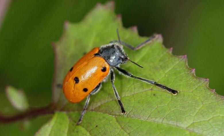

Recognition of lacnea
Lacnea is a small beetle, in fact it does not exceed 8 mm in length. Both species have yellow-orange elytra (wings) with black spots: one in the humeral and two, aligned, positioned in the distal third.
The two species are therefore not distinguished by the number of spots.
In both the body and the head are blackish. The difference lies in the pronotum, which in the Lachnaia italica it has more rounded rear corners than those of the Lachnaia sex-punctata.
