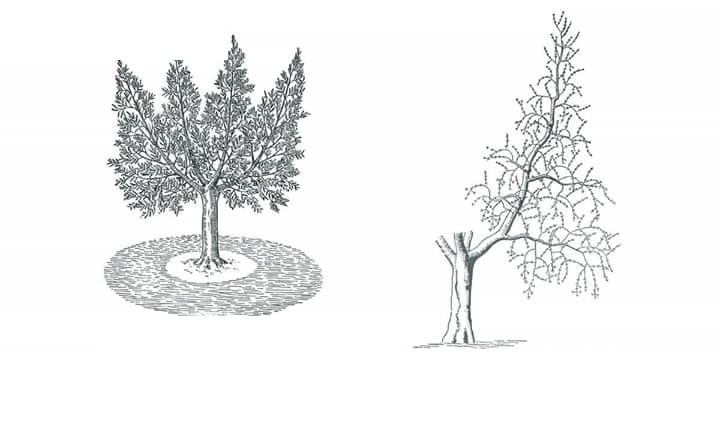

The polyconic vase training form
The polyconic vase shape of the olive tree consists of a skeletal structure with 3 or 4 branches starting from a short trunk (from 50 cm to 1 m) for shakers on tractors. Alternatively, it may not include the trunk, if harvesting is done with hand harvesters.
The primary branches are inclined from 30 to 45 degrees outwards, with an ever smaller diameter towards the height, limiting the flow of sap towards the tops, thus enhancing secondary lateral branches at the bottom, considered braking, whose length decreases from the bottom upward.
The inclination serves to avoid, especially with the climate of the southern regions, that the bark is desiccated, also due to the excessive compulsive sucking of the ventral part, exposing the tissues to risks from burns caused by excessive insolation.
The secondary branches are orthogonal, at 90 degrees, therefore they start downwards with respect to the primary ones, with a diameter never greater than half. They go to occupy their own space, without ever overlapping others or dubbing on the same level. The result is a cone shape, open inside.
