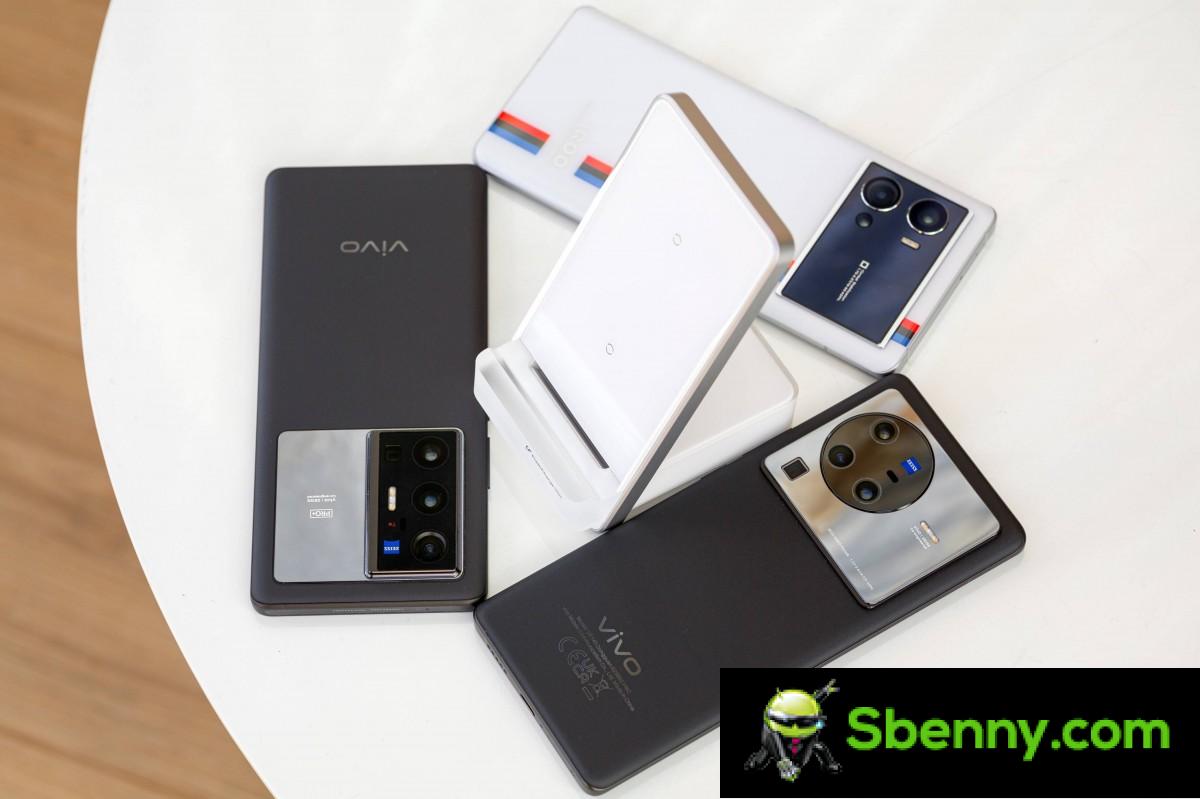

Smartphone “charging wars” are fought mostly on the wired front, where some companies have already crossed the 100W mark giving you a full 0-100% charge in about or even less than 20 minutes. But every now and then the battle shifts to the wireless front where even manufacturers are reaching speeds that were unthinkable a couple of years ago.
One such device is the vivo X80 Pro which we reviewed not long ago and which supports 50W wireless charging. The only problem is that you need a specialized wireless charging stand. We recently received one such charger in our office – vivo’s 50W Wireless Flash Charger and we are now ready to report on what it allows.
To achieve blazingly fast charging times, the vivo X80 Pro has a dual-cell battery with two charge pumps, an industry standard approach used on most new flagship phones today. With its combined battery cell capacity of 4,700mAh, the X80 Pro managed a whopping 79 hours in our proprietary battery life test. The X80 Pro comes with a bundled 80W FlashCharge adapter (20V / 4A) and the corresponding USB-C cable. In our wired charging test, we reached the maximum charge power of 65-66W at 17V and 4A, resulting in a full charge of 39 minutes.
vivo claims that the 50W wireless flash charger can charge the X80 Pro to 50% in 23 minutes while a full charge should take 50 minutes or just 11 minutes longer than the 80W wired FlashCharge solution. The company obviously confirms that actual charging power is “dynamically regulated” and is “subject to actual use” which means you shouldn’t expect 50W power that blows your phone all the time.

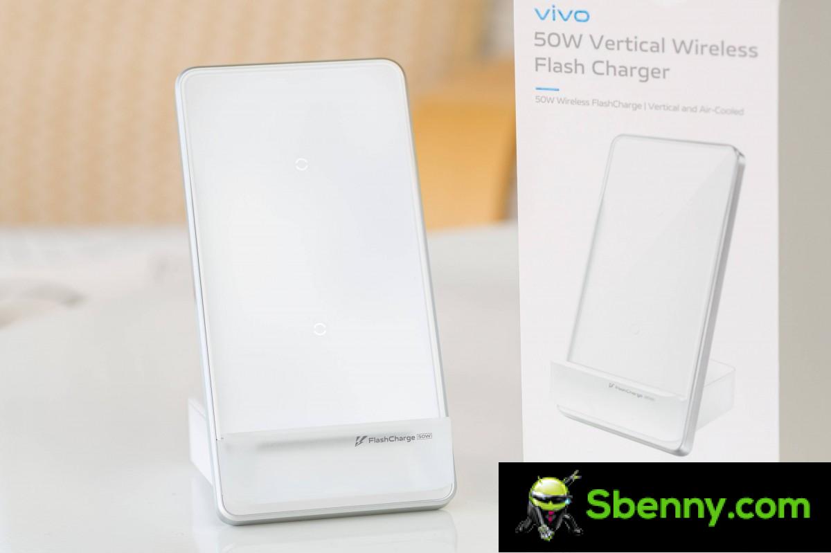

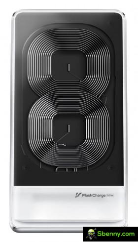

A few short words about the 50W FlashCharge Wireless Charger. It features a dual coil design that allows you to place your phone in portrait or landscape orientation, the latter useful if you want to watch a video while the phone is charging. The cradle features a 60-degree tilt and an integrated cooling fan at the bottom, reaching up to 3,600rpm.
A look inside the charging coils and fan of the 50W vivo flash charger
The charging pad gives it a white and silver look with a glossy surface in the charging cradle area and a satin finish on the back, all in plastic. There is also a frosted clear tip at the front that holds the device you are charging. Vivo is introducing a special night charging mode on its supported phones where the fan will limit itself to 27 Db so your sleep is not disturbed. It won’t be as fast, but it doesn’t matter if you’re spending the night with your phone anyway.
The back of the charger features a USB-C port so you can safely replace cables if needed. Speaking of cables, it’s a little disappointing to see no cables or power supplies in the charger’s retail box given its $ 70 (currently up to $ 40) retail price.
The wireless charger weighs 196 grams while the X80 Pro’s 80W charger and bundled cable come in at an additional 150 grams, so if you’re traveling somewhere and want to bring your own 50W FlashCharge charger and use its maximum known power you’ll be carrying nearly 350 grams of equipment, not counting the phone itself.
