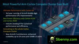

The high-power Cortex-X4, medium Cortex-A720 and small Cortex-A520 were introduced today and will work in tandem to balance performance and efficiency. ARM also introduced DSU-120 which is what drives the DynamIQ Shared Unit system which allows different CPU cores to work together.
With DSU-120, chipset manufacturers can create designs with up to 14 CPU cores
Current high-end chipsets have 1+3+4 or 1+4+3 configurations. While DSU-120 for CPUs up to 14 cores, smartphones will likely stick to 8 in total. However, the standard configuration will probably change to 1+5+2.

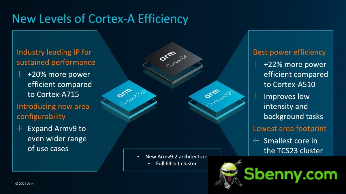

The new Cortex-X4 will tackle single-threaded heavy tasks, promises 15% faster performance than the X3 for the same power (which itself ran 25% faster than the X2). For the same performance, the X4 can offer a massive 40% reduction in power consumption. But the X4 is built for speed, in fact, it’s the fastest CPU core ARM has ever designed and is expected to hit clock speeds of 3.4GHz.
The Cortex-A720 is optimized for efficiency even more than previous A700 cores. It is 20% more efficient than the A715, which itself was 20% more efficient than the A710. With five A720 cores, they’ll do most of the heavy lifting for multi-threaded workloads and do it efficiently.
Finally, the Cortex-A520 is still a tidy core. It is designed so that two cores can share execution units to take up as little silicon space as possible. The other design goal was to draw power, and the A520 is 22% more efficient than the A510. On higher-end chipsets these will likely focus on background tasks.

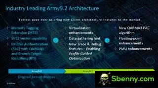

Note that none of these cores support the older 32-bit ARM instruction set – software running on these will be optimized for ARMv9. All companies that have yet to support 32-bit can use the Cortex-A710 core.
