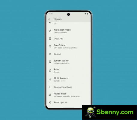

Repair mode in settings
Google bases the repair mode on the Dynamic System Updates feature. Normally, this allows you to download a new Android image and run it as a guest OS without overwriting the current installation. It’s a great way to run and test a generic system image (GSI). For repair mode, however, DSU will simply boot the original operating system image, but with a new user account configured.
This will give the repair technician access to the phone’s hardware to test what works and what doesn’t, just like on a phone restored to factory settings. However, restoring your data when you get your phone back will be much easier than dealing with Android’s backup system.
