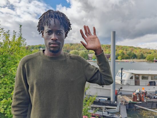

Asus ROG Phone 7 – Accurate subject exposure
Samsung Galaxy A34 5G – Fairly accurate subject exposure, slight clipping in the background
Honor Magic5 Pro – Accurate subject exposure

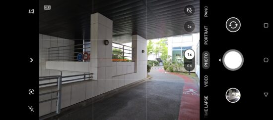

Preview tests analyze the quality of the camera app’s image preview, with a focus on the difference between capture and preview, particularly regarding dynamic range and the application of bokeh. The smoothness of exposure, color and focus adaptation when switching from the minimum to the maximum available zoom factor is also evaluated. The preview frame rate is measured using the LED universal timer.
Asus ROG Phone 7 – Capture
Asus ROG Phone 7 – Preview – Similar render to capture but with a slight clipping of the lights in the background
