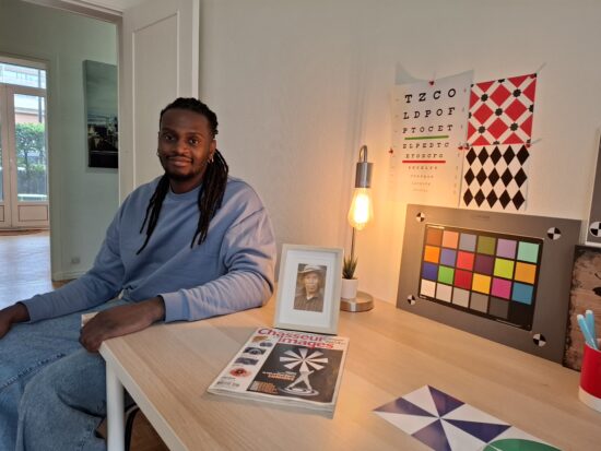

The Samsung Galaxy A55 5G is one of the latest models in Samsung’s A series and the successor to the A54 5G, which we tested previously. The new model shares some camera hardware specs with its predecessor, and in our tests, camera performance was also at a similar level. Overall results were pretty average for this class of device, with accurate exposure and fairly good consistency when shooting in decent lighting conditions.
However, in more demanding situations, such as heavily backlit scenes, very low light, or scenes with motion, our testers observed a number of glitches, including hue shifts around cropped areas, ghosting, and a noticeable drop in tracking capabilities of autofocus. Surprisingly, our testers found the A55’s bokeh mode to be less accurate, with more subject segmentation errors and trigger errors, than its predecessor.
The lack of a dedicated camera module meant that telezoom image quality was quite limited. In terms of ultra-wide, the A55 offers slightly wider dynamic range than the A54 but exposes higher noise levels, especially in the shadow areas of the frame. Furthermore, the color rendering was less pleasant, with some color diffusion. In video mode, stabilization wasn’t quite at the same level as best-in-class devices, such as the Apple iPhone 15 Pro.
