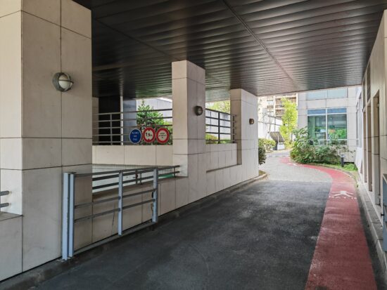

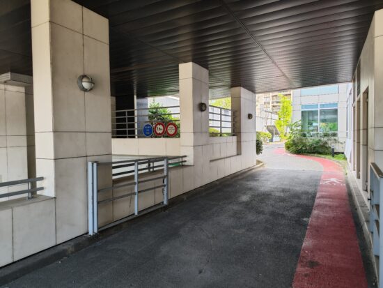

Exposure is one key attribute for technically good pictures. We evaluate the brightness of the main subject through various use cases such as landscape, portrait, or still life. Other factors evaluated are the contrast and the dynamic range, eg. the ability to render visible details in both bright and dark areas of the image. Repeatability is also important because it demonstrates the camera’s ability to provide the same rendering when shooting several images of the same scene.
On average, the 12S Ultra produces accurate target exposure down to low light, and dynamic range is among the best we have seen, capturing good detail in both the brightest and darkest parts of a scene. However, the high dynamic range comes at a cost, and our testers observed some contrast issues, especially in more difficult backlit scenes. This issue appears to be better under control on the older Mi 11 Ultra model.
Xiaomi 12S Ultra: accurate exposure, wide dynamic range
Apple iPhone 13 Pro Max: accurate exposure, more limited dynamic range
Honor Magic4 Ultimate: accurate exposure, wide dynamic range

The 12S Ultra’s preview on the display does not fully reflect the captured image, especially in high-contrast conditions or when bokeh mode is activated. So, even if the conditions aren’t ideal for taking an image, you should push the shutter anyway. The end result might look better than expected.
Xiaomi 12S Ultra, preview: HDR not applied to preview, bokeh effect very different to capture
Xiaomi 12S Ultra, capture: much wider dynamic range than preview, different bokeh effect to preview

The 12S Ultra video footage offers good target exposure. Dynamic range is wide in outdoor and indoor conditions and close to the latest iPhones, which lead the pack in this respect. Differences are noticeable in low light, though. Our testers also found that exposure was unstable and that exposure adaptation in changing light conditions was not always smooth.
Xiaomi 12S Ultra, video still: fairly good dynamic range and good target exposure
Apple iPhone13 Pro Max, video still: fairly good dynamic range and good target exposure
Honor Magic4 Ultimate, video still: fairly good dynamic range but slight underexposure
