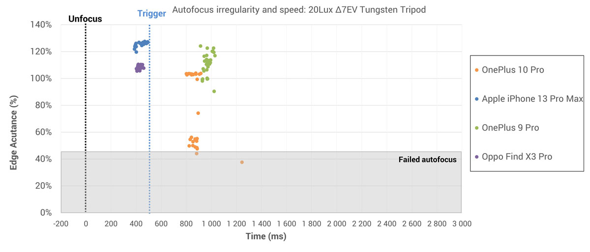

In these tests, we analyze autofocus accuracy and shooting time, including repeatability, in the lab. We test focus failures, depth of field, and tracking of moving subjects using perceptual analysis of real-life images.
The 10 Pro’s autofocus is slower than the competition in most conditions, and sometimes also not very consistent. The predecessor OnePlus 9 Pro performs similarly, but the iPhone 13 Pro Max and Oppo Find X3 Pro are generally faster and more repeatable. In this graph, we can see that 10 Pro varies more than the other devices in terms of accuracy, and its autofocus also fails for a few shots.
This graph plots edge acutance Cons shooting time measured on the AFHDR set up on a series of pictures. All pictures are taken at 20 lux with tungsten illuminant and high dynamic range (7EV), with the device mounted on a tripod, 500ms after the target is defocused. Edge acutance is measured on the four edges of the deadleaves, shooting time is measured on an LED Universal Timer.

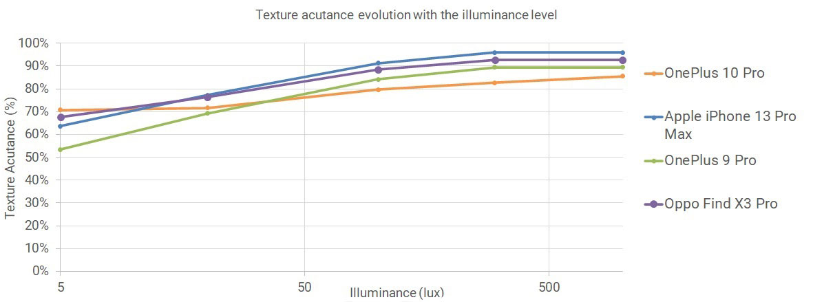

In these tests we analyze texture on faces and objects, including objects in motion, in a range of light conditions, using several lab test setups and perceptual analysis of real-life images.

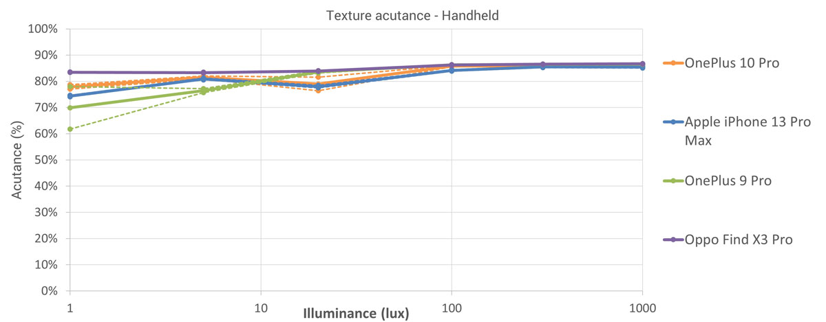

The OnePlus 10 Pro captures good detail but, as expected, a slight loss of texture is noticeable in low light. Overall texture performance is close to the competition. In this graph, we can see the 10 Pro does well and is quite close to the iPhone 13 Pro Max in all conditions. The Oppo is slightly better in low light, but the 10 Pro shows an improvement over its predecessor in dim conditions.
This graph shows texture acutance Cons the light level (in lux) for handheld shooting.

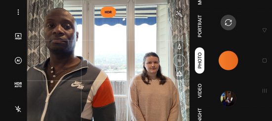

In these tests, we analyze the image quality of the preview image and the differences between preview images and captured images, particularly in terms of exposure, dynamic range, and bokeh effect. We also check the smoothness of the field-of-view changes in the preview image when zooming with both buttons or when using the pinch-zoom gesture.
When looking at the preview image on the phone’s display, target exposure is similar to the final image. However, dynamic range is more limited, so areas that are clipped in preview might show more detail in the final capture.
Preview: similar target exposure to capture but more limited dynamic range results in highlight clipping in the background
Capture, no highlight clipping
