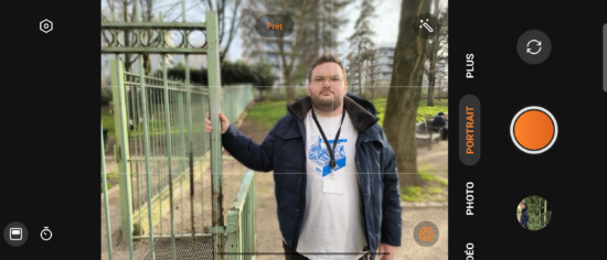

The preview tests analyze the image quality of the camera app’s image preview, with particular attention to the difference between the capture and the preview, especially regarding the dynamic range and the application of the bokeh effect. The uniformity of exposure, color and focus adaptation when zooming from the minimum to the maximum available zoom factor is also evaluated. The preview frame rate is measured using the Universal Timer LED.
Oppo Find N2 Flip, preview: darker exposure and lack of detail compared to the capture
Oppo Find N2 Flip, capture
