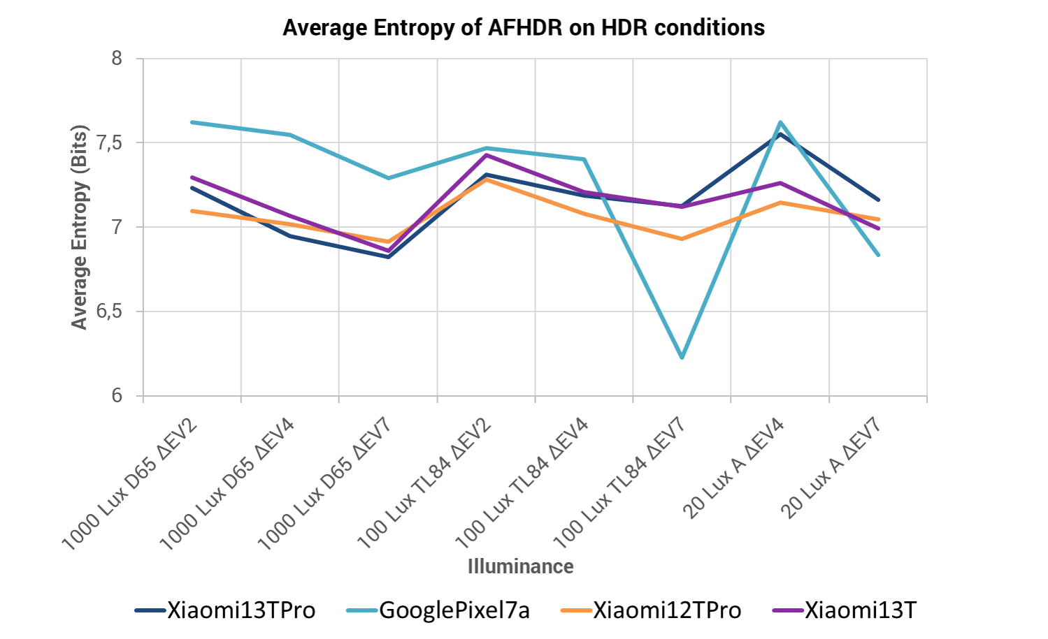

The Xiaomi 13T Pro showed high dynamic range in almost all tested conditions, except when the subject was moving in the scene, which made the HDR rendering rather unstable. The dynamic range was mostly on par with the Xioami 13T and showed slightly better results than the 12T Pro.
Entropy (ability to recover information in the highest parts of a scene) given for different illuminations and dynamics of the scene

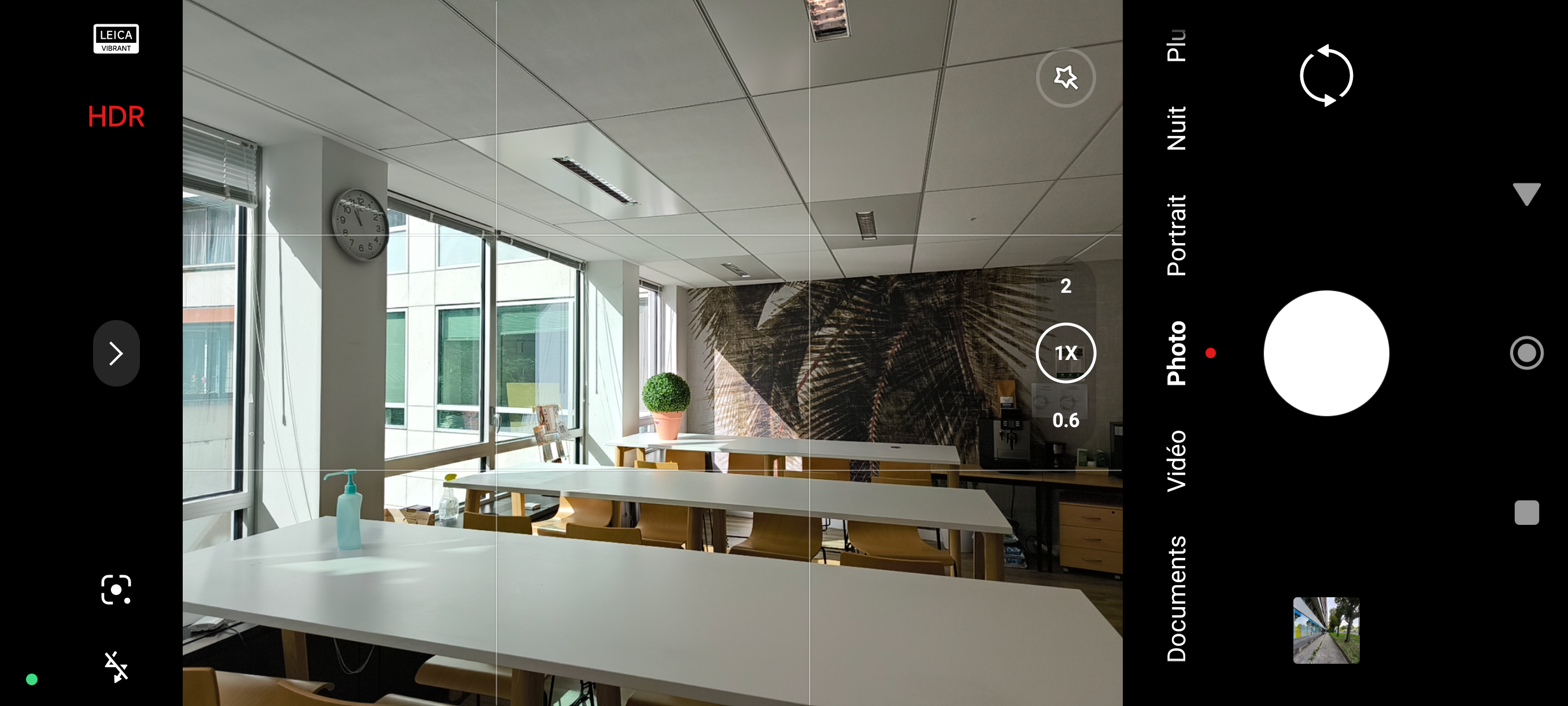

Preview tests analyze the quality of the camera app’s image preview, with a focus on the difference between capture and preview, particularly regarding dynamic range and the application of bokeh. The smoothness of exposure, color and focus adaptation when switching from the minimum to the maximum available zoom factor is also evaluated. The preview frame rate is measured using the LED universal timer.
Xiaomi 13T Pro – Preview screen
Xiaomi 13T Pro – Exposure and dynamic range quite similar in the final shot compared to the preview
