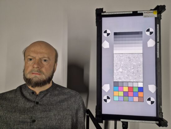

Preview tests analyze the quality of the camera app’s image preview, with a focus on the difference between capture and preview, particularly regarding dynamic range and the application of bokeh. The smoothness of exposure, color and focus adaptation when switching from the minimum to the maximum available zoom factor is also evaluated. The preview frame rate is measured using the LED universal timer.
Our testers noticed a slight difference between the image capture and the on-screen preview, especially in terms of dynamic range, which was more limited in the preview.
Samsung Galaxy S24 – Preview at 100 Lux EV4
Samsung Galaxy S24 – Capture at 100 Lux EV4
