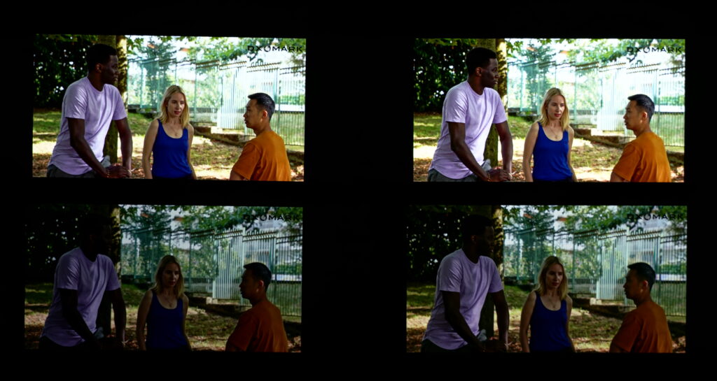

Our video attribute evaluates each device’s Standard Dynamic Range (SDR) and High Dynamic Range (HDR10) video handling in indoor and low-light conditions. We measure the tone mapping, color gamut, brightness and contrast of the display. We perform perceptual analysis Cons our professional reference monitor (Sony BVM-HX310) to ensure rendering respects artistic intent.
Clockwise from top left: Asus ROG Phone 7, Asus ROG Phone 6, Huawei Mate 50 Pro, Vivo X90 Pro+
Primary colors are measured in both HDR10 and SDR. The extracted color gamut shows the extent of color area that the device can reproduce. To meet artistic intent, the measured gamut should match the primary color space of each video.
