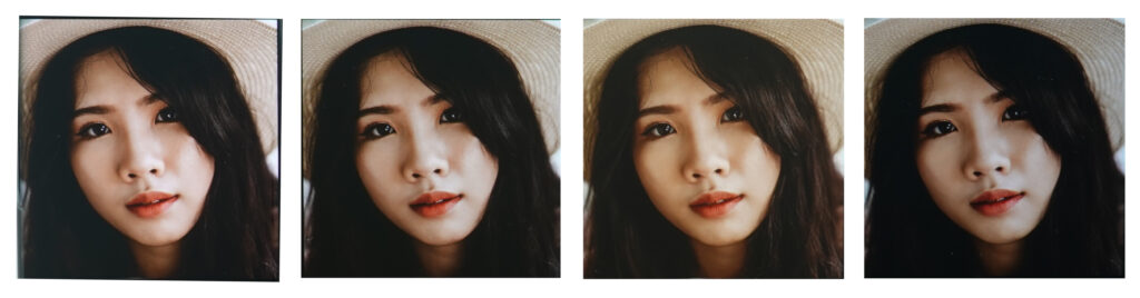

Readability evaluates the user’s ease and comfort in viewing stationary content, such as photos or a web page, on the display under different lighting conditions. Our measurements performed in laboratories are complemented by perceptual tests and analyses.
Skin tone rendering in an indoor environment (1000 lux).
From left to right: Honor Magic6 Pro, Google Pixel 8 Pro, Apple iPhone 15 Pro Max, Samsung Galaxy S24 Ultra

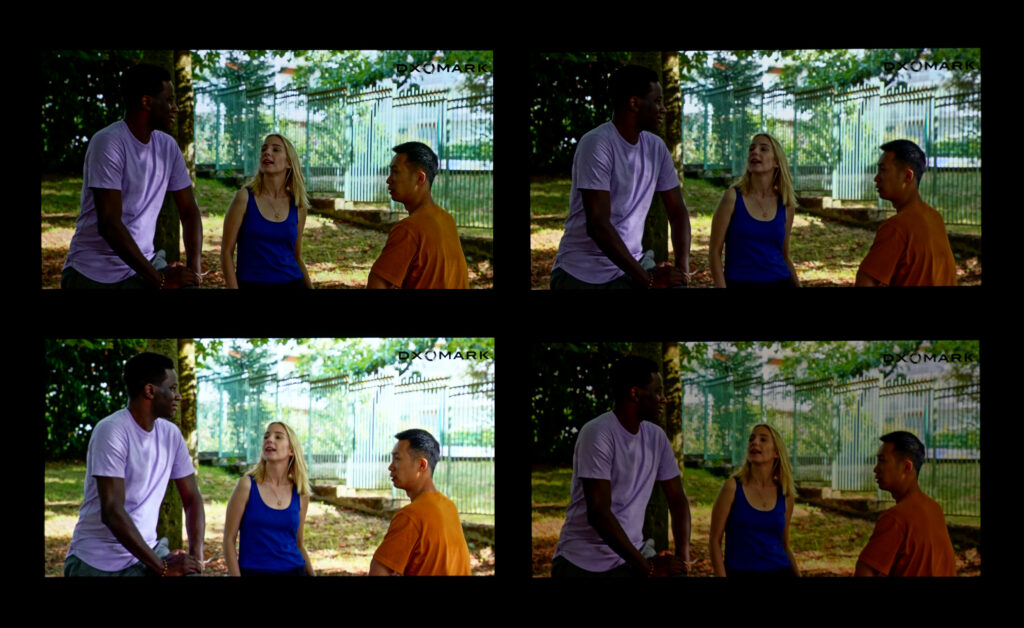

The video attribute evaluates the handling of Standard Dynamic Range (SDR) and High Dynamic Range (HDR10) video in indoor and low-light conditions. Our measurements performed in laboratories are complemented by perceptual tests and analyses.
Clockwise from top left: Honor Magic6 Pro, Google Pixel 8 Pro, Apple iPhone 15 Pro Max, Samsung Galaxy S24 Ultra
