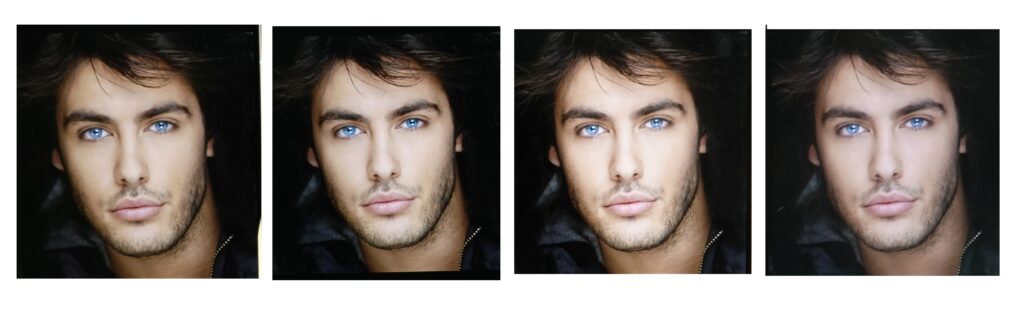

Skin tone rendering in an indoor environment (1000 lux).
From left to right: Vivo X200 Ultra, Samsung Galaxy S25 Ultra, Oppo Find X8 Pro, Honor Magic7 Pro

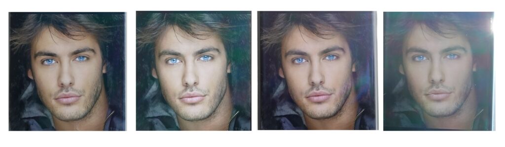

Skin tone rendering in a solar environment (>90,000 lux).

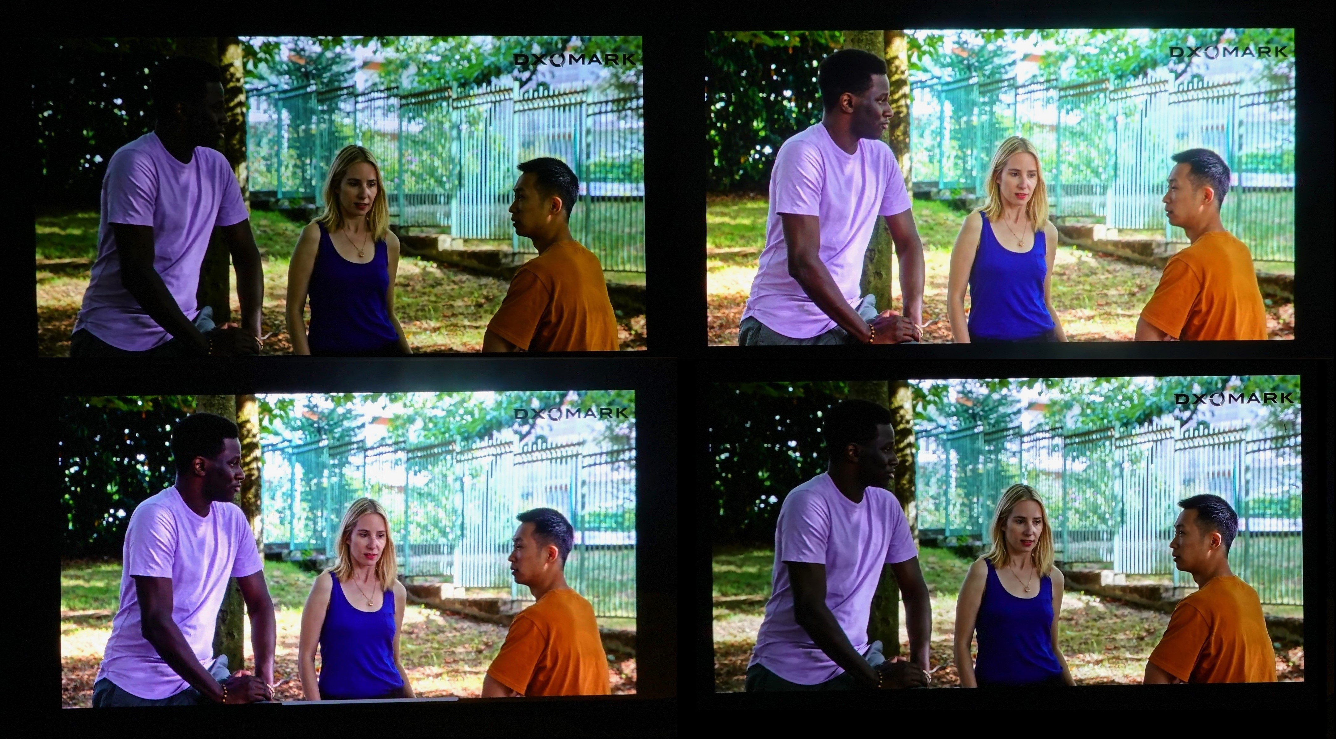

The video attribute evaluates the handling of Standard Dynamic Range (SDR) and High Dynamic Range (HDR10) video in indoor and low-light conditions. Our measurements performed in laboratories are complemented by perceptual tests and analyses.
Clockwise from top left: Vivo X200 Ultra, Samsung Galaxy S25 Ultra, Oppo Find X8 Pro, Honor Magic7 Pro
