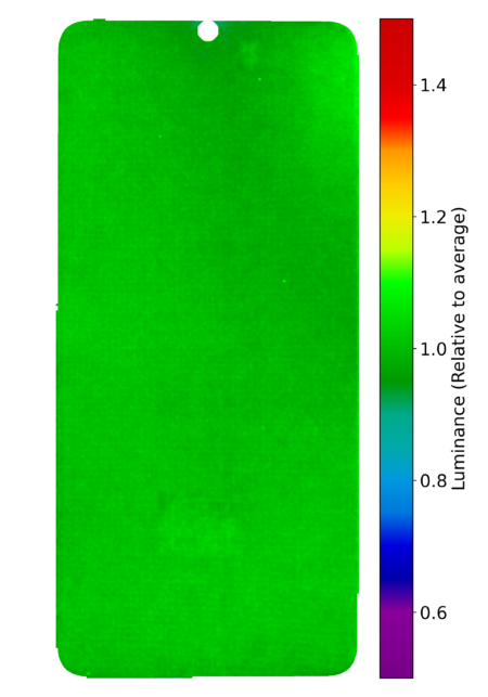

The S23+ falls between the basic S23 and the S23 Ultra when it comes to screen size. While the S23+ showed a good maximum brightness of 1500 nits when viewing photos on the screen (under 20,000 lux), this brightness, however, was 100 nits lower than the S23 and 270 nits lower than the S23 Ultra. This cost the S23+ some valuable points in terms of readability. In the touch attribute, the 23+ outperformed the S23 Ultra as the smaller device was able to handle corner taps better. However, the S23+’s touch performance failed to surpass the S23’s even slightly smaller screen in the touch attribute.

- Excellent uniformity
