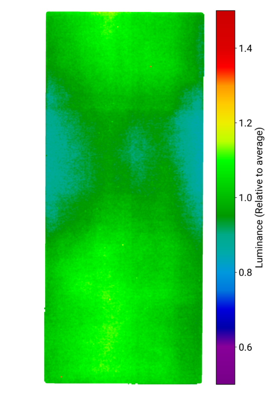

This graph shows the uniformity of the display with a gray pattern of 20%. The more green the color is visible, the smoother the display.

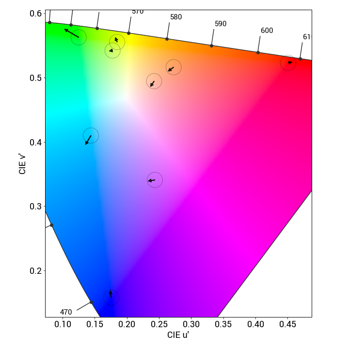

Color fidelity measurements
Sony Xperia 10 IV, color fidelity at 1000 lux in the sRGB color space
Sony Xperia 10 IV, color fidelity at 1000 lux in the DCI-P3 color space
Each arrow represents the color difference between a target color model (arrow base) and its actual measurement (arrowhead). The longer the arrow, the more visible the color difference. If the arrow stays inside the circle, the color difference will only be visible to trained eyes.

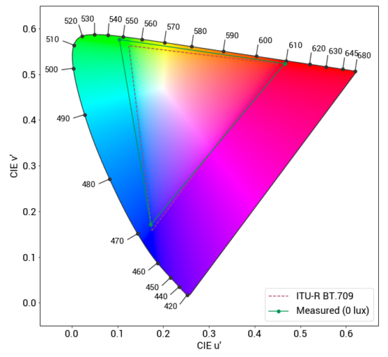

Range coverage for video content
Primary colors are measured in both HDR10 and SDR. The extracted color gamut shows the extent of the color area that the device can render. To respect the artistic intent, the measured gamut should match the main color space of each video.

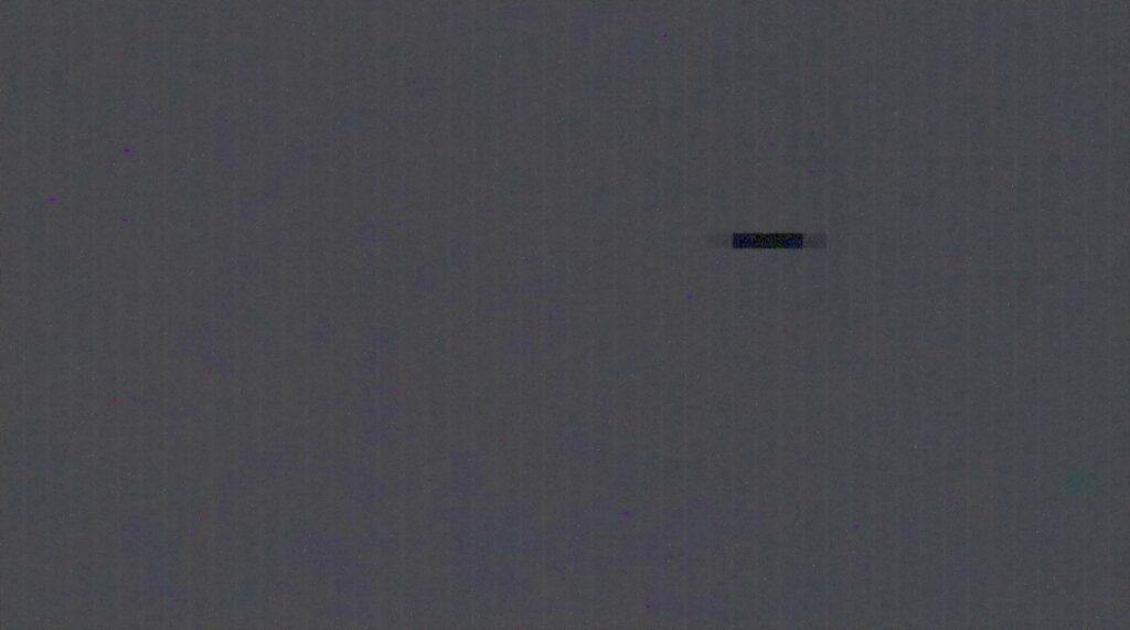

The video frame drops
These long exposure photos present the number of frame irregularities in a 30-second video. A good performance shows a regular pattern (a flat gray image or a drop-down pattern).
