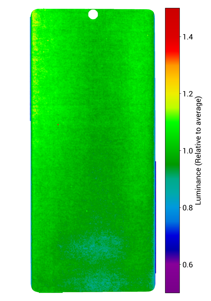

- Good color rendering indoors and in low light conditions
- Uniform in brightness and color

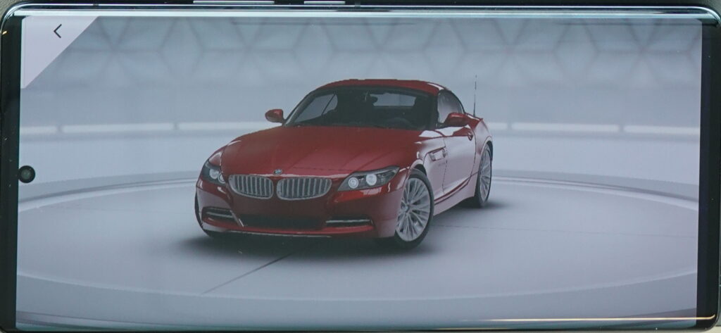

- Visible frame drops when playing video games

The highlight of the smartphone’s screen was its color rendition, where it scored top marks for its consistently good and faithful color rendition indoors and in low-light conditions. The screen colors of the Vivo X90 Pro+ maintained uniformity and color fidelity for the most part.

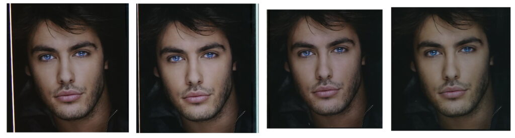

The color attribute evaluates the device’s ability to faithfully reproduce colors. Measurements taken include fidelity, white point color, and gamut coverage. We perform color assessments for different lighting conditions to see how well the device can handle color in its surroundings. Colors are measured using a spectrophotometer in a controlled lighting environment. The perceptual analysis of the color rendering compares with the reference model displayed on a calibrated professional monitor.
Clockwise from top left: Vivo X90 Pro+, Vivo X90 Pro, Vivo X80 Pro (Snapdragon), Samsung Galaxy S23 Ultra

Evaluating artifacts means checking performance, image rendering, and motion artifacts that can impact the end-user experience. SBMARK accurately measures device reflectance and flicker, and evaluates the impact of residual aliasing when playing video games, among other characteristics.
Aliasing (foreground)
Vivo X90Pro+
