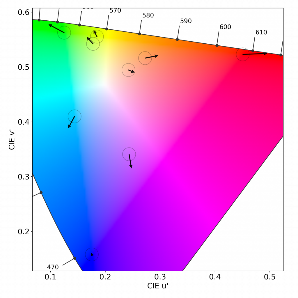

In the graphs below, each arrow represents the color difference between a target color model (arrow base) and its actual measurement (arrowhead). The longer the arrow, the greater the visible color difference. If the arrow stays inside the circle, the color difference will only be visible to trained eyes. In the case of the Oppo Find X5, the color spaces could have been handled better.
Oppo Find X5, color fidelity at 1000 lux in the sRGB color space

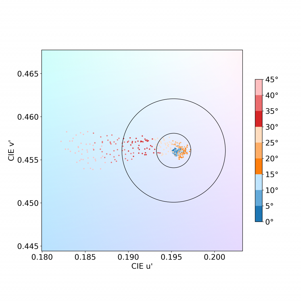

Oppo Find X5, color fidelity at 1000 lux in the DCI-P3 color spaceThis graph shows the shift of color when the screen is tilted. Each point represents a measurement with a particular angle. The points inside the inner circle show no color change in the corner; those between the inner and outer circle have shifts that only trained experts will see; but those who fall outside the outer circle are noted.
White dot on the corner, Oppo Find X5
