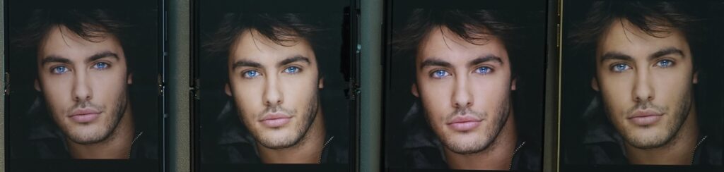

Readability indoors (1000 lux).
From left: Samsung Galaxy Z Flip4, Samsung Galaxy Z Flip 3, OnePlus 10 Pro, Apple iPhone 13 Pro Max

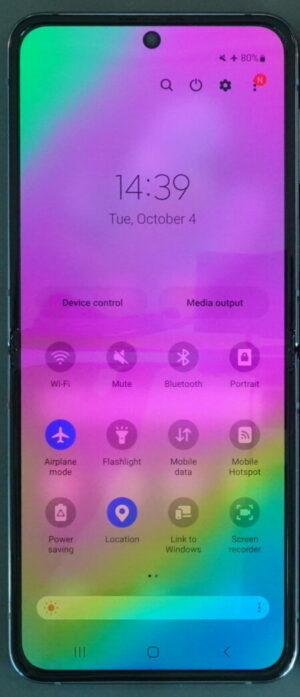

This graph shows the uniformity of the display with a gray pattern of 20%. The more green the color is visible, the smoother the display.

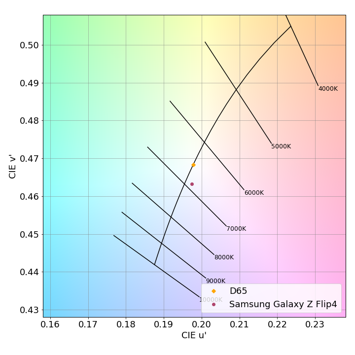

White point under illuminant D65 at 1000 lux

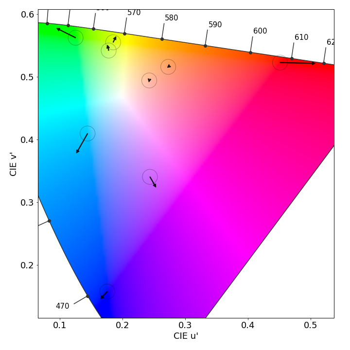

Color fidelity measurements
Samsung Galaxy Z Flip4, 1000 lux color fidelity in the sRGB color space
Samsung Galaxy Z Flip4, 1000 lux color fidelity in the DCI-P3 color space
Each arrow represents the color difference between a target color model (arrow base) and its actual measurement (arrowhead). The longer the arrow, the more visible the color difference. If the arrow stays inside the circle, the color difference will only be visible to trained eyes.

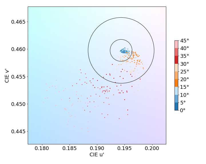

Behavior of the color on the corner
This graph shows the shift of color when the screen is tilted. Each point represents a measurement with a particular angle. The points inside the inner circle show no color change in the corner; those between the inner and outer circle have shifts that only trained experts will see; but those who fall outside the outer circle are noted.

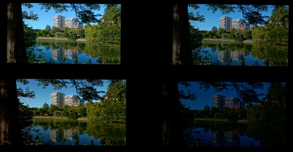

Our video attribute evaluates the Standard Dynamic Range (SDR) and High Dynamic Range (HDR10) video handling of each device indoors and in low light conditions. We measure the tone mapping, color gamut, brightness and contrast of the display. We perform perceptual analysis Cons our professional reference monitor (Sony BVM-HX310) to ensure that the rendering respects the artistic intent.
Clockwise from top left: Samsung Galaxy Z Flip4, Samsung Galaxy Z Flip 3, OnePlus 10 Pro, Apple iPhone 13 Pro Max

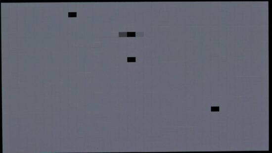

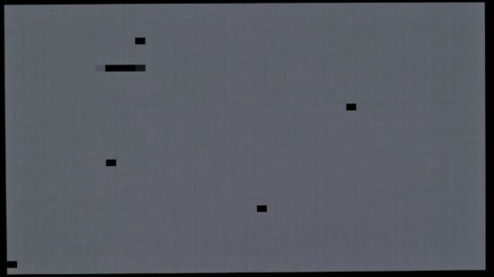

The video frame drops
These long exposure photos present the number of frame irregularities in a 30 second video. A good performance shows a regular pattern (a flat gray image or a drop-down pattern).

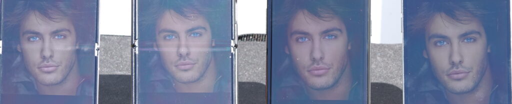

The Z Flip4’s low artifact score is not only due to its flickering and visible crease, but also to its behavior when viewed through polarized sunglasses, as shown below.

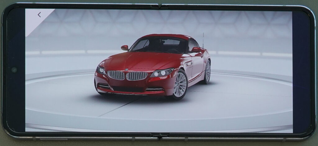

Alias (foreground)
