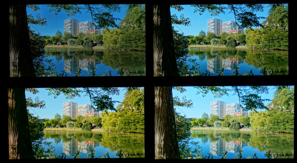

Readability evaluates the ease and comfort with which users can read the still content (photos and web) on the display under various real-life conditions. SBMARK uses its Display Bench to recreate ambient light conditions ranging from total darkness to bright sunlight. In addition to laboratory tests, perceptual analysis is also performed in real-life environments.
From left: Vivo X90 Pro, Vivo X80 Pro (Snapdragon), Samsung Galaxy S23 Ultra, Apple iPhone 14 Pro Max
Readability in a sunlight environment (>90,000 lux).

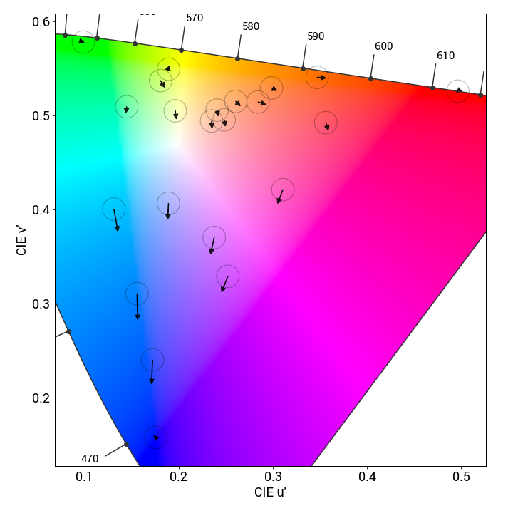

The color attribute evaluates the device’s ability to faithfully reproduce colors. Measurements taken include fidelity, white point color, and gamut coverage. We perform color assessments for different lighting conditions to see how well the device can handle color in its surroundings. Colors are measured using a spectrophotometer in a controlled lighting environment. The perceptual analysis of the color rendering compares with the reference model displayed on a calibrated professional monitor.
Clockwise from top left: Vivo X90 Pro, Vivo X80 Pro (Snapdragon), Samsung Galaxy S23 Ultra, Apple iPhone 14 Pro Max
Color fidelity measurements
Vivo X90 Pro, color fidelity at 1000 lux in the sRGB color space
Vivo X90 Pro, color fidelity at 1000 lux in Display-P3 color space
Each arrow represents the color difference between a target color pattern (arrow base) and its actual measurement (arrow tip). The longer the arrow, the more visible the color difference. If the arrow stays inside the circle, the color difference will only be visible to trained eyes.

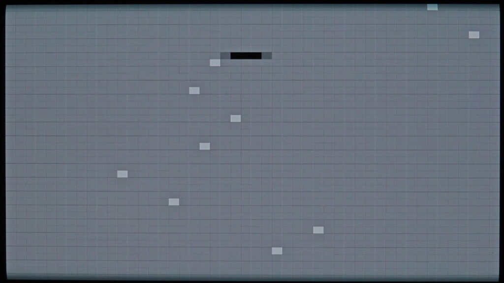

The motion attribute evaluates the handling of dynamic content. Frame drops, motion blur, and playback artifacts are examined using games and videos.
The video frame drops
These long exposure photos feature the number of frame irregularities in a 30 second video. Good performance shows a regular pattern (a flat gray image or a pull-down pattern).
