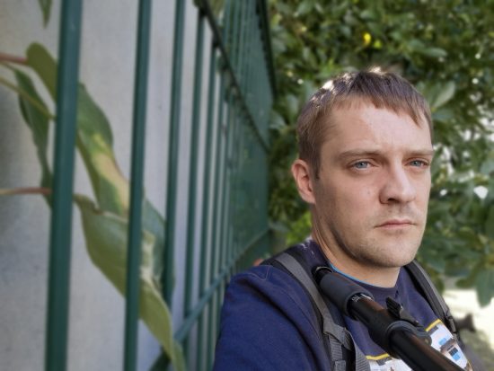

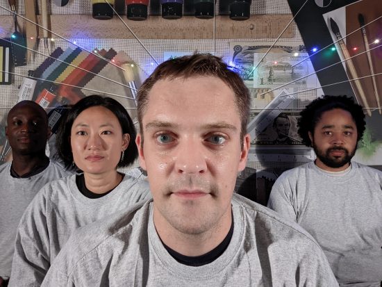

These samples show the Google Pixel 6 Pro’s exposure performance in bright light conditions. Target exposure is generally accurate and more consistent in consecutive shots than competitors. The dynamic range is quite wide, and the shadow contrast is better than the comparison devices.
Google Pixel 6 Pro, precise target exposure and fairly wide dynamic range, great contrast in the shadows (hair and background)
Apple iPhone 13 Pro Max, precise target exposure and fairly wide dynamic range
Huawei P50 Pro, precise target exposure and fairly wide dynamic range

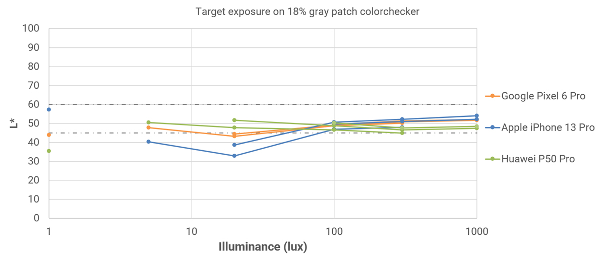

This graph shows the Google Pixel 6 Pro’s exposure performance in all light levels.
Exposure comparison: The Pixel 6 Pro achieves brighter exposure in low light than the iPhone 13 Pro, and the metered target exposure is generally high.

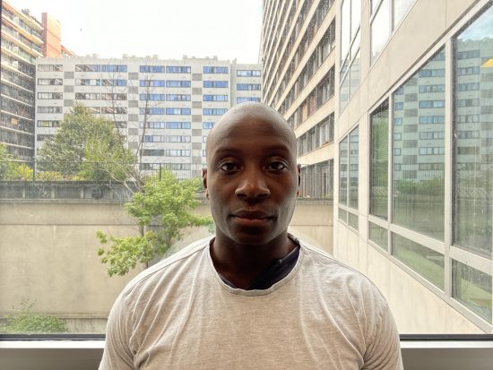

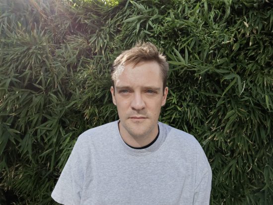

These samples show the color performance of the Google Pixel 6 Pro in bright light conditions. Skin tones and color are generally accurate. While many devices struggle to produce accurate white balance in scenes with monochrome backgrounds, the Pixel 6 Pro delivers better results in such conditions than the iPhone 13 Pro and Huawei P50 Pro.
Google Pixel 6 Pro, neutral white balance, beautiful skin tones
Apple iPhone 13 Pro Max, warm white balance and skin tone
Huawei P50 Pro, desaturated skin tones, accurate white balance

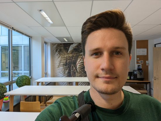

These samples show the color performance of the Google Pixel 6 Pro indoors. In this type of scene, the white balance is generally neutral with beautiful skin tones on all skin types, even in difficult shots with high contrast. The Apple iPhone 13 Pro generally has a white balance cast with an orange skin tone rendering.
Google Pixel 6 Pro, neutral white balance, accurate skin tones
Apple iPhone 13 Pro Max, cast white balance, orange skin tone
Huawei P50 Pro, neutral white balance, accurate skin tones

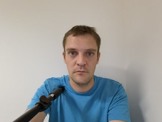

Autofocus tests evaluate the accuracy of focusing on the subject’s face, the repeatability of precise focus, and depth of field. While a shallow depth of field can be nice for a single-subject selfie or close-up shot, it can be problematic in specific conditions like group selfies; both situations are tested. The accuracy of the focus is also evaluated in all real images taken, from 30 cm to 150 cm, and in low light conditions up to the outdoors.
These samples show the Google Pixel 6 Pro’s focusing performance at a distance of 30cm from the subject. At this close range, the face is slightly blurry, with less sharpness than the comparison devices. At 120cm (selfie stick distance) the sharpness is on the same level as the iPhone 13 Pro.
Google Pixel 6 Pro, focus
Google Pixel 6 Pro, crop: face slightly out of focus
Apple iPhone 13 Pro, focus
Apple iPhone 13 Pro, crop: face in focus
Huawei P50 Pro, crop: face in focus

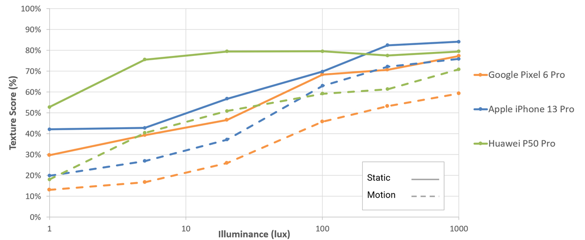

Texture tests analyze the level of detail and texture of subjects in images taken in the laboratory as well as in real-life scenarios. For natural shots, special attention is paid to the level of detail in the facial features, such as the eyes. Objective measurements are performed on map images taken under various lighting conditions from 1 to 1000 lux and different types of dynamic range conditions. The charts used are the proprietary SBMARK (DMC) chart and the Dead Leaves chart.
This graph shows the Google Pixel 6 Pro’s texture performance in the lab under different light levels. The measured texture acuity is slightly lower than that of the iPhone and Huawei, especially in scenes with motion. This results in a greater loss of detail than the comparison devices.
Texture comparison: The Pixel 6 Pro’s front camera offers high sharpness, comparable to that of the Huawei P50 Pro.

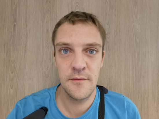

These samples show the Google Pixel 6 Pro’s texture performance inside.
Google Pixel 6 Pro, interior textures
Google Pixel 6 Pro, crop: loss of detail

Evolution of the sharpness of the texture with the level of illuminance
This graph shows the evolution of texture sharpness with the lux level for two sealing conditions. Texture sharpness is measured on the Dead Leaves graph in the Close-up Dead Leaves setting.

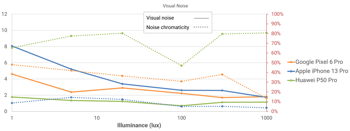

This graph shows the Google Pixel 6 Pro’s noise performance in the lab under different light levels.
Visual noise is a metric that measures the noise perceived by end users. It takes into account the sensitivity of the human eye to different spatial frequencies under different observation conditions.
Noise comparison: Noise is well controlled on the Pixel 6 Pro and Huawei P50 Pro. Noise is noticeable on the Apple iPhone 13 Pro.
