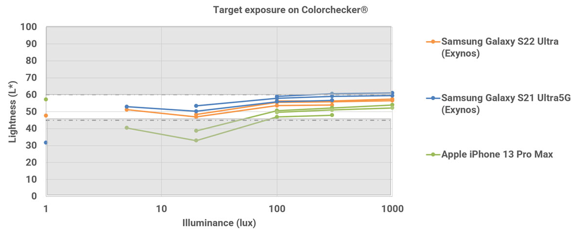

In this graph, you can see that the S22 Ultra delivers good exposure in all conditions. Overall exposure is better than on the comparison devices.
This graph shows lightness measured on the 18% gray patch of the Colorchecker® chart Cons the light level (in lux). The white area represents the region where the lightness is considered correct.

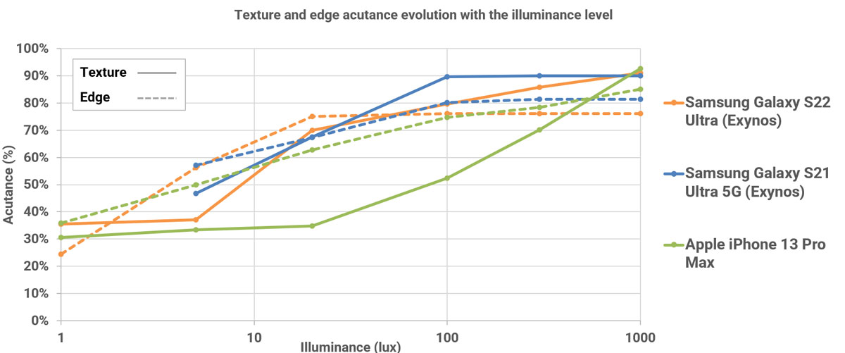

In these tests we analyze texture on faces and objects, including objects in motion, in a range of light conditions, using several lab test setups and perceptual analysis of real-life images.
Our lab measurements show that texture acutance on the S22 Ultra is higher than on the comparison devices for most conditions, except very bright and very low light.
This graph shows texture acutance Cons the light level (in lux) for tripod-mounted shooting. Texture acutance is measured on the deadleaves chart in the Selfie deadleaves setup.

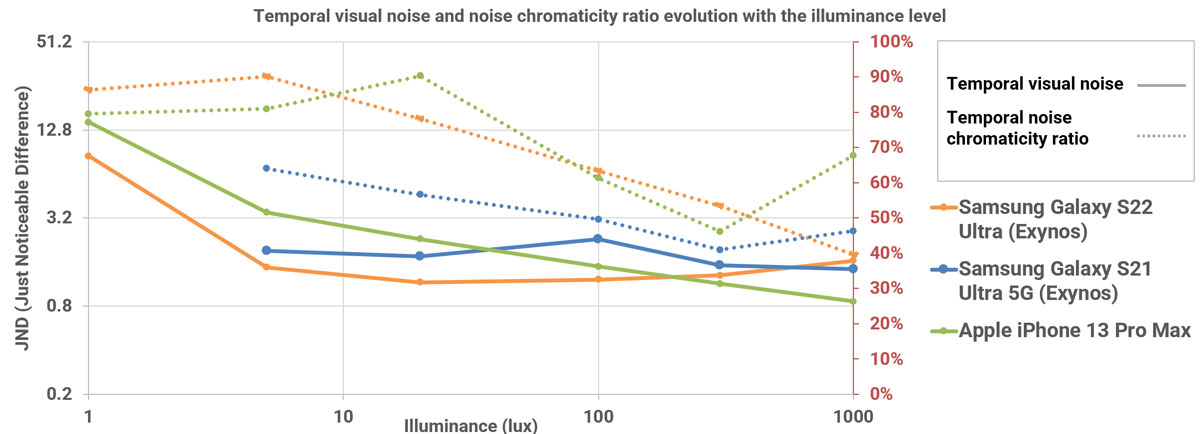

The results we can see in the clips above are confirmed by our lab measurements. Noise levels on the S22 Ultra in the lab are lower than on the iPhone 13 Pro Max.
This graph shows temporal visual noise and temporal noise chromaticity ratio Cons the light level (in lux). Temporal visual noise and noise chromaticity ratio are measured on the visual noise chart in the video noise setup.
