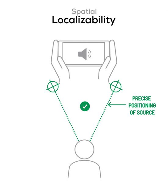

Secondary attributes of spatial tests include identifying the location of a specific sound, its positional balance, distance, and amplitude.
In our tests, the Pixel 8 Pro delivered good spatial results overall. The breadth of the projected sound stage was particularly good, thanks to an immersive stereo image that went beyond the physical confines of the device. Our testers found the distance rendering to be accurate and the balance well-centered. However, the localizability of individual sound sources in the scene was slightly blurry, mainly due to inconsistent treble rendering. Depth rendering could also have been better as it sounded a little flat, with little difference in perceived distance between distinct sound sources.
