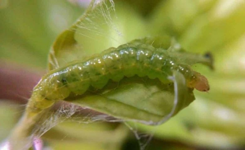

Olive margaronia larvae go through six stages of development. As soon as they are born they are slightly larger than the egg that contained them. The color is yellowish, with a body provided with bristles, located on black tubercles.
When mature, they have a small head, with the rest of the body gradually swollen to the center and then narrowed again to the caudal end. The color is bright green, with a yellowish head. When fully developed, they measure about 2 cm in length. Later, when it is about to transform itself into a chrysalis, it shortens and swells, turning towards brown.

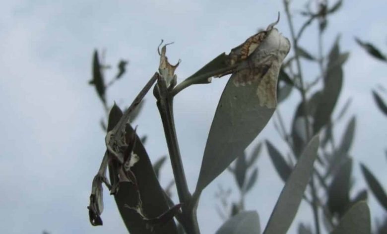

On the olive tree the damage of the borer is more significant, as it can be damaged both the vegetation and the ripening olives. The damage is done by the larvae at different age stages. These practice erosions on the leaves, concentrating on the new apical shoots, especially those of suckers and suckers.
The fourth age larvae can erode the drupe, sometimes even exposing the core.

The larvae live in groups on the leaves, building shelters of silky threads and feeding on the most tender apicals. As they grow, they separate, living isolated in the vegetation and continuing to erode the leaf blade.
The sixth-age larva gathers 2-3 leaves, between which it weaves a silky white cocoon within which it incrisalida. The transformation into a butterfly takes place at different times, depending on the temperatures.
