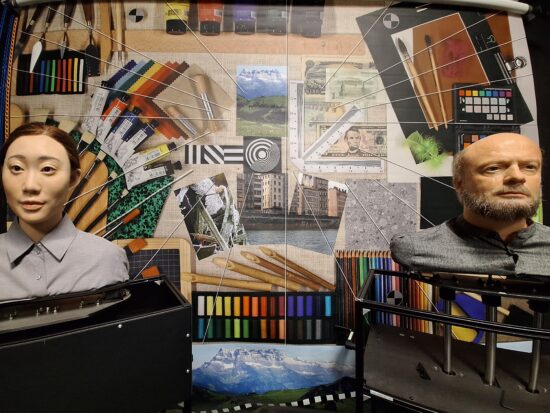

For scoring and analysis, SBMARK engineers capture and evaluate more than 2,600 test images in both controlled laboratory environments and outdoor, indoor, and low-light natural scenes using camera presets. The photographic protocol is designed to take into account the main use cases and is based on typical shooting scenarios, such as portrait, family and landscape photography. Evaluation is performed by visually inspecting images Cons a natural scene reference and by performing objective measurements on laboratory-acquired graph images under various lighting conditions from 1 to 1,000+ lux and color temperatures from 2,300 K to 6,500 K.

Texture tests analyze the level of detail and texture of subjects in images taken in the lab as well as real-life scenarios. For natural shots, special attention is paid to the level of detail in the light and dark areas of the image. Objective measurements are performed on map images taken under various lighting conditions from 1 to 1000 lux and different types of dynamic range conditions. The charts used are the proprietary SBMARK (DMC) chart and the Dead Leaves chart.
SBMARK CHART (DMC) Detail Retention Score vs. Lux Levels for Tripod and Handheld Conditions
This graph shows the evolution of the DMC Retention of Detail score with lux level, for two holding conditions. The DMC Detail Retention Score is derived from an AI-powered metric trained to evaluate texture and detail rendition on a selection of crops from our SBMARK chart.
