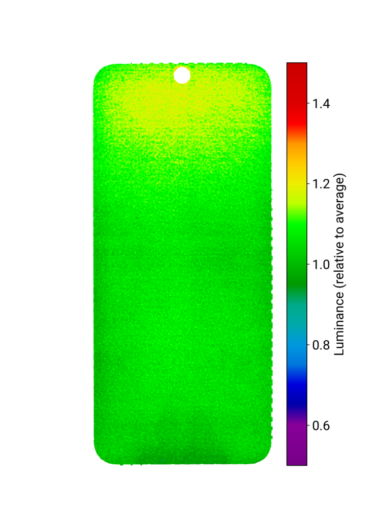

Uniformity
This graph shows the distribution of the luminance during the entire display panel. The uniformity is measured with a 20%gray motif, with brilliant green that indicates ideal luminance. A bright green color evenly scattered on the screen indicates that the brightness of the display is uniform. Other colors indicate a loss of uniformity.
