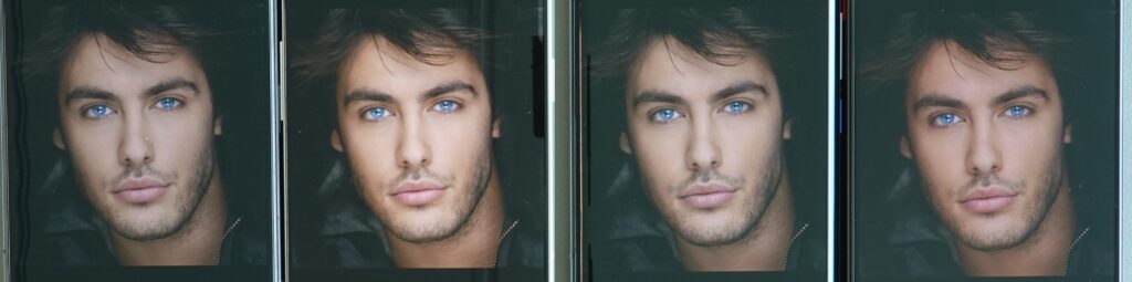

Readability evaluates the ease and comfort with which users can read stationary content (photos and web) on the display under various real-life conditions. SBMARK uses its Display Bench to recreate ambient light conditions ranging from total darkness to bright sunlight. In addition to laboratory tests, perceptual analysis is also carried out in real-life environments.
Left to right: Poco F4 GT, Realme GT 2 Pro, Vivo IQOO 9 Pro, Nubia RedMagic 7 Pro

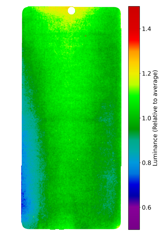

This graph shows the uniformity of the display with a gray pattern of 20%. The more green the color is visible, the smoother the display.

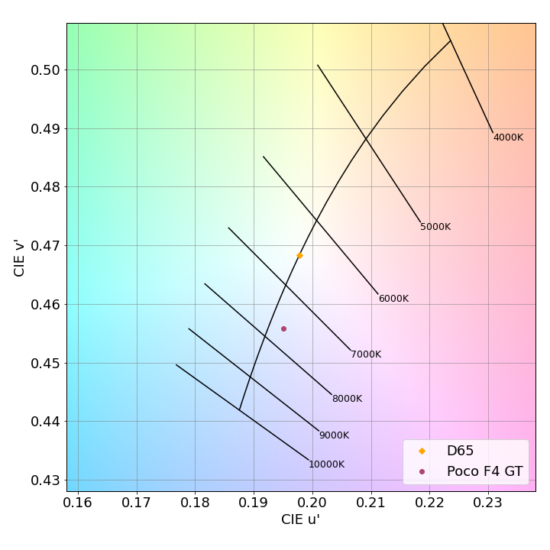

White point under illuminant D65 at 1000 lux

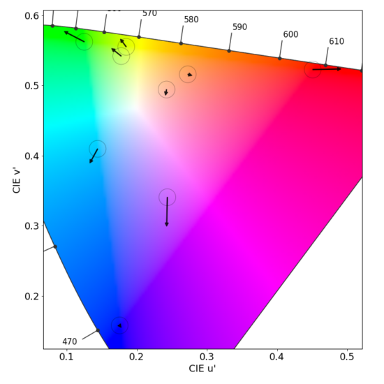

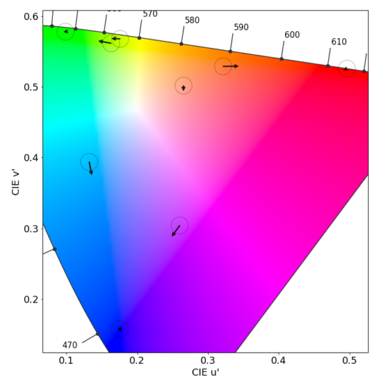

Color fidelity measurements
Little F4 GT, color fidelity at 1000 lux in the sRGB color space
Little F4 GT, color fidelity at 1000 lux in the DCI-P3 color space
Each arrow represents the color difference between a target color model (arrow base) and its actual measurement (arrowhead). The longer the arrow, the more visible the color difference. If the arrow remains inside the circle, the color difference will only be visible to trained eyes.

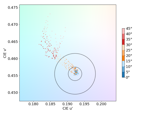

Behavior of the color on the corner
This graph shows the color shift when the screen is tilted. Each point represents a measurement with a particular angle. The points inside the inner circle show no color change in the corner; those between the inner and outer circle have shifts that only trained experts will see; but those who fall outside the outer circle are noted.

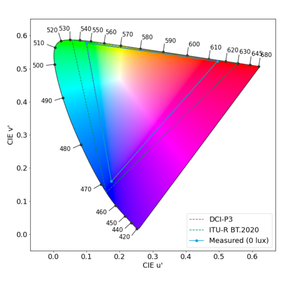

Range coverage for video content
Primary colors are measured in both HDR10 and SDR. The extracted color gamut shows the extent of the color area that the device can render. To respect the artistic intent, the measured gamut should match the main color space of each video.

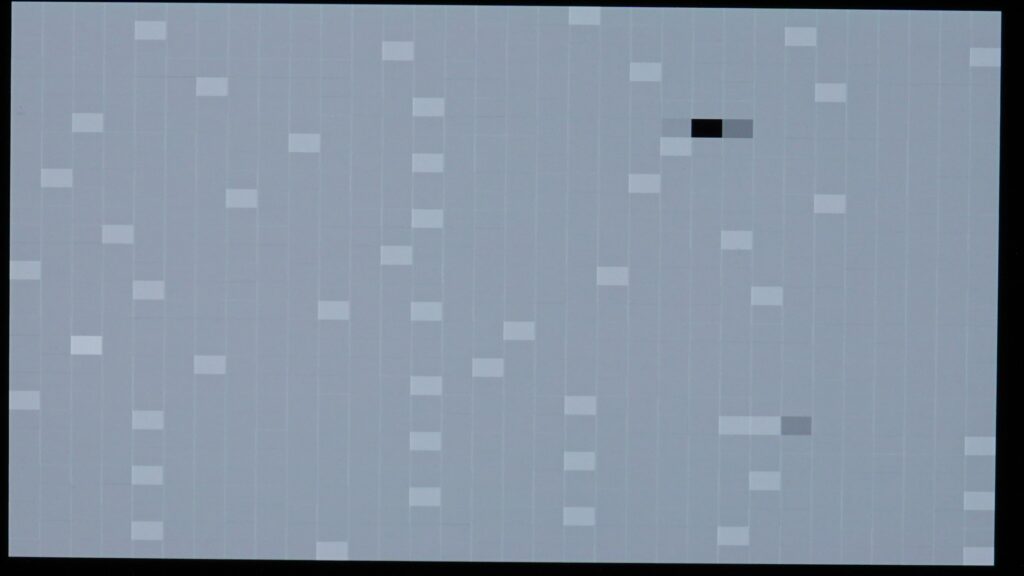

The video frame drops
These long exposure photos present the number of frame irregularities in a 30 second video. A good performance shows a regular pattern (a flat gray image or a drop-down pattern).
