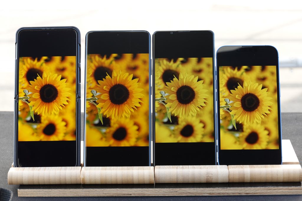

Readability in a sunlight environment (> 90 0000 lux).
From left to right: Samsung Galaxy Z Flip3 5G, Samsung Galaxy S21 Ultra 5G (Snapdragon), Sony Xperia 1 III, Apple iPhone 13

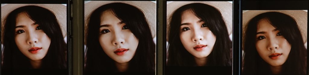

Readability at a 45 ° angle

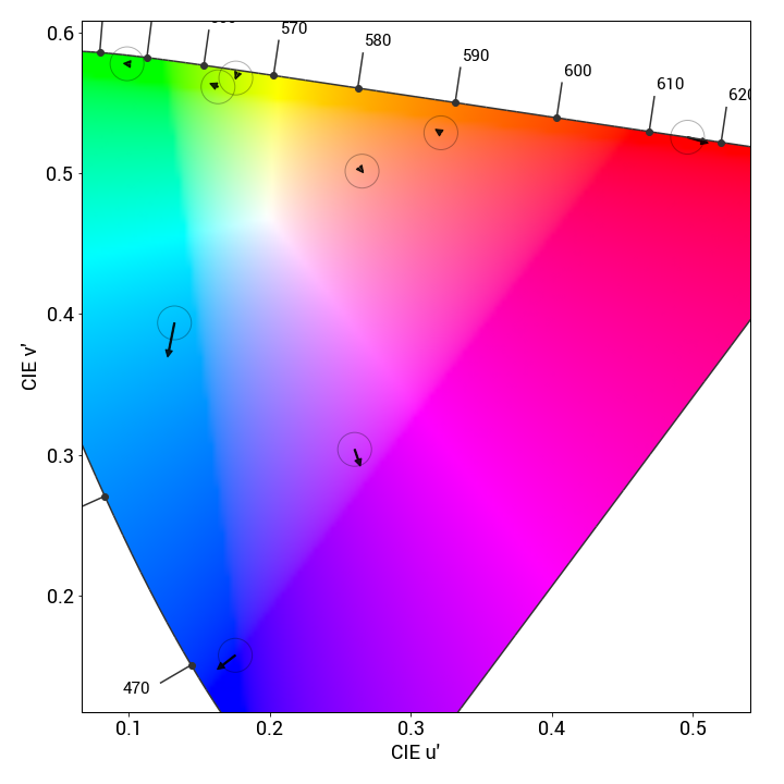

Color fidelity measurements
Samsung Galaxy Z Flip3 5G, 1000 lux color fidelity in the sRGB color space
Samsung Galaxy Z Flip3 5G, color fidelity to 1000 lux in the DCI-P3 color space
Each arrow represents the color difference between a target color model (arrow base) and its actual measurement (arrowhead). The longer the arrow, the more visible the color difference. If the arrow stays inside the circle, the color difference will only be visible to trained eyes.

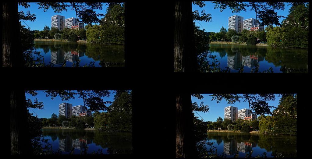

Our video attribute evaluates the Standard Dynamic Range (SDR) and High Dynamic Range (HDR10) video handling of each device indoors and in low-light conditions. We measure the tone mapping, color gamut, brightness and contrast of the display. We perform perceptual analysis Cons our professional reference monitor (Sony BVM-HX310) to ensure that the rendering respects the artistic intent.
Clockwise from top left: Samsung Galaxy Z Flip3 5G, Samsung Galaxy S21 Ultra 5G (Snapdragon), Apple iPhone 13, Sony Xperia 1 III

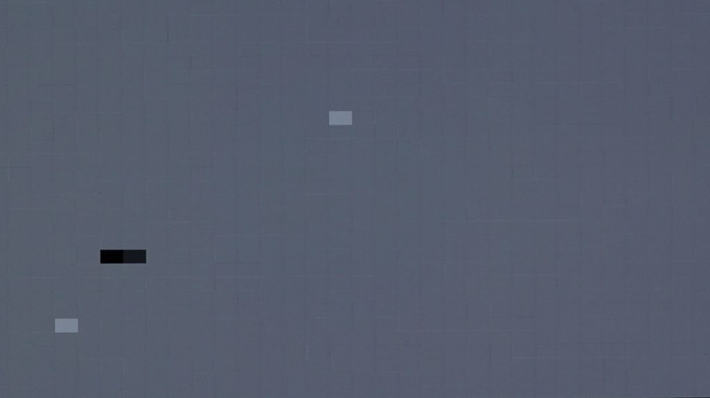

The video frame drops
These long exposure photos present the number of frame irregularities in a 30 second video. A good performance shows a regular pattern (a flat gray image or a drop-down pattern).

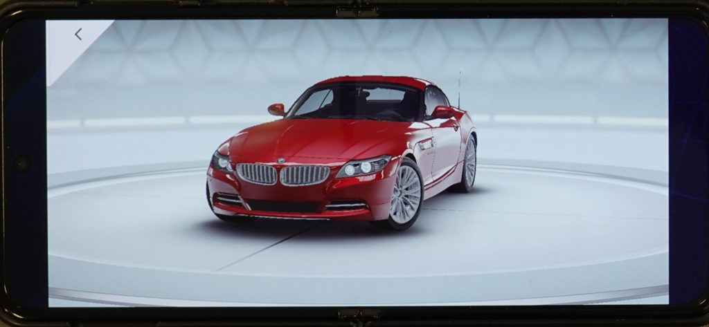

Evaluating artifacts means checking performance, image rendering, and motion defects that can affect the end-user experience. SBMARK accurately measures device reflectance and flickering and evaluates the impact of residual aliasing when playing video games, among other characteristics.
The measurements above show the reflection of the device within the visible spectrum range (400nm to 700nm). It includes both diffuse and specular reflection.
This graph represents the variation frequencies of the illumination; the highest peak gives the main flicker frequency.

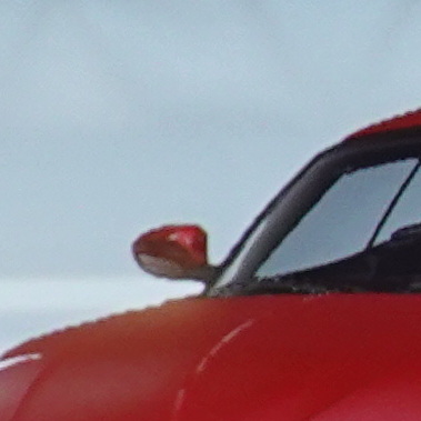

Alias ​​(foreground)
Samsung Galaxy Z Flip3 5G – Crop 1
Samsung Galaxy Z Flip3 5G – Crop 2
Samsung Galaxy Z Flip3 5G – Crop3
