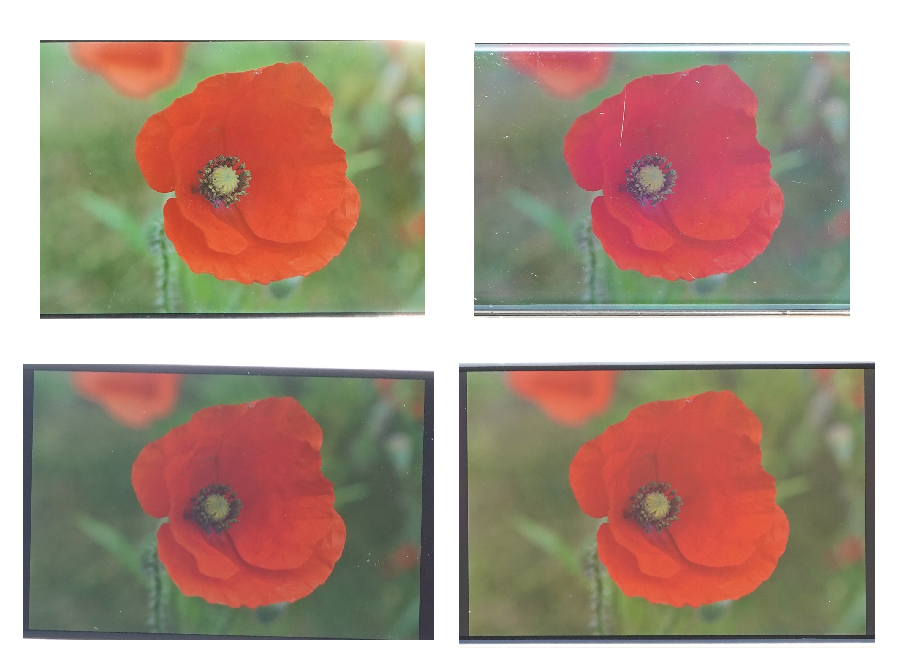

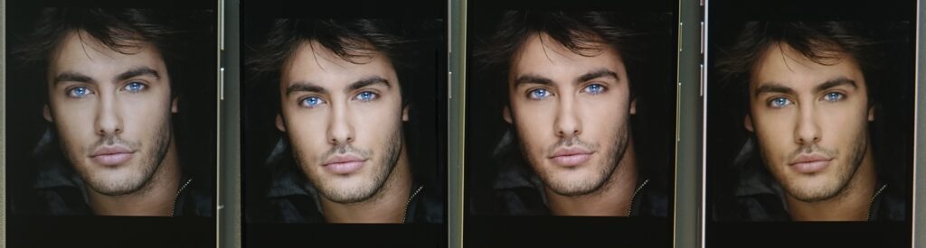

Readability evaluates the ease and comfort with which users can read the still content (photos and web) on the display under various real-life conditions. SBMARK uses its Display Bench to recreate ambient light conditions ranging from total darkness to bright sunlight. In addition to laboratory tests, perceptual analysis is also performed in real-life environments.
From left to right: Xiaomi 13, Xiaomi 12, Google Pixel 7, Apple iPhone 14

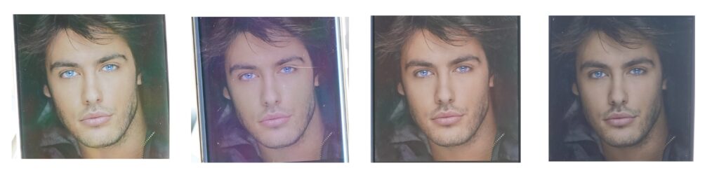

Readability in a sunlight environment (>90,000 lux).

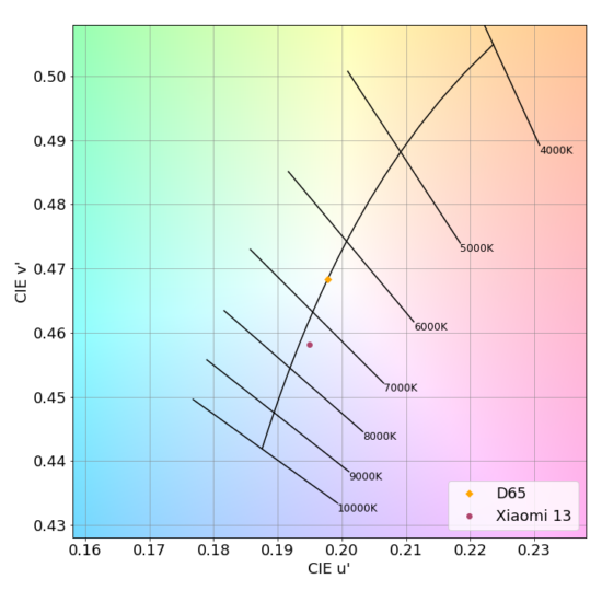

The color attribute evaluates the device’s ability to faithfully reproduce colors. Measurements taken include fidelity, white point color, and gamut coverage. We perform color assessments for different lighting conditions to see how well the device can handle color in its surroundings. Colors are measured using a spectrophotometer in a controlled lighting environment. The perceptual analysis of the color rendering compares with the reference model displayed on a calibrated professional monitor.
Clockwise from top left: Xiaomi 13, Xiaomi 12, Google Pixel 7, Apple iPhone 14

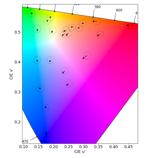

Color fidelity measurements
Xiaomi 13, color fidelity at 1000 lux in the sRGB color space
Xiaomi 13, color fidelity at 1000 lux in Display-P3 color space
Each arrow represents the color difference between a target color pattern (arrow base) and its actual measurement (arrow tip). The longer the arrow, the more visible the color difference. If the arrow stays inside the circle, the color difference will only be visible to trained eyes.

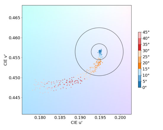

Color behavior on the corner
This graph shows the color shift when the screen is tilted. Each point represents a measurement at a particular angle. The dots within the inner circle show no color change in the corner; those between the inner and outer circle have shifts that only trained experts will see; but those which fall outside the outer circle are evident.

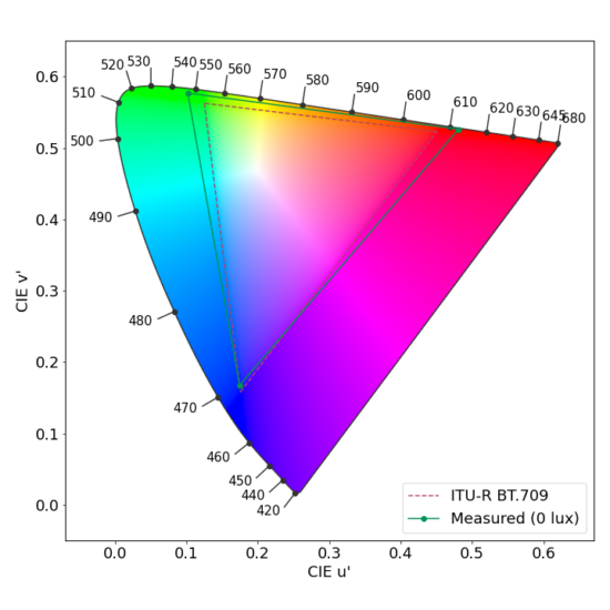

Our video attribute evaluates each device’s Standard Dynamic Range (SDR) and High Dynamic Range (HDR10) video handling in indoor and low-light conditions. We measure the tone mapping, color gamut, brightness and contrast of the display. We perform perceptual analysis Cons our professional reference monitor (Sony BVM-HX310) to ensure rendering respects artistic intent.
Primary colors are measured in both HDR10 and SDR. The extracted color gamut shows the extent of color area that the device can render. To meet artistic intent, the measured gamut should match the primary color space of each video.

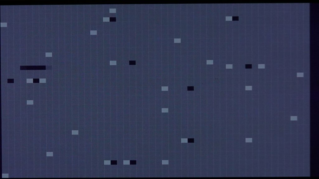

The motion attribute evaluates the handling of dynamic content. Frame drops, motion blur, and playback artifacts are examined using games and videos.
The video frame drops
These long exposure photos feature the number of frame irregularities in a 30 second video. Good performance shows a regular pattern (a flat gray image or a pull-down pattern).

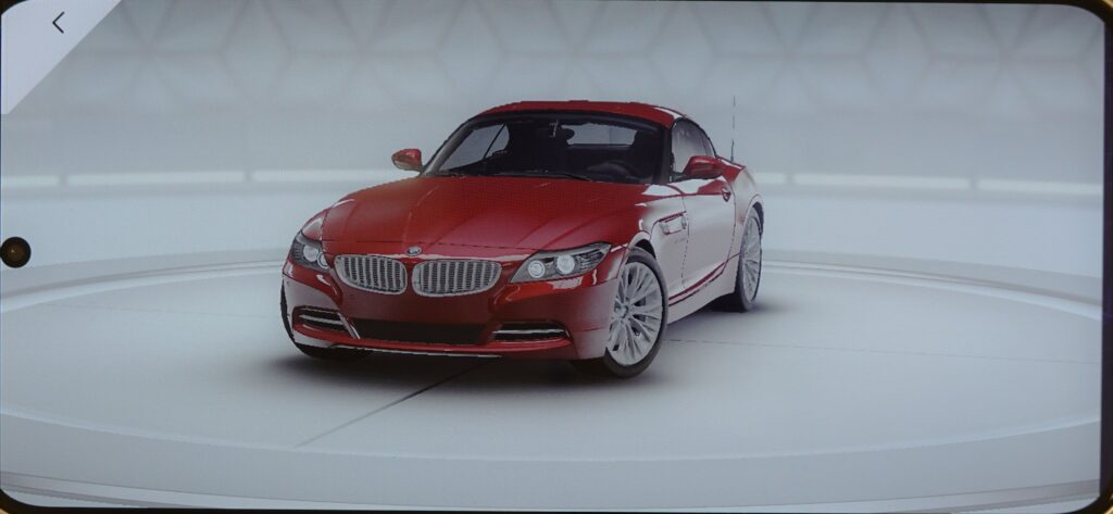

Evaluating artifacts means checking performance, image rendering, and motion artifacts that can impact the end-user experience. SBMARK accurately measures device reflectance and flicker, and evaluates the impact of residual aliasing when playing video games, among other characteristics.
Aliasing (foreground)
