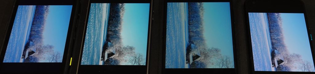

Readability indoors (1000 lux).
From left: Crosscall Action-X5, Fairphone 4, Nokia 8.3, Asus Zenfone 8

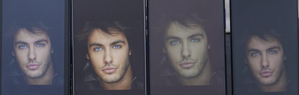

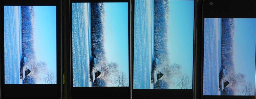

Readability in an outdoor environment (20,000 lux).

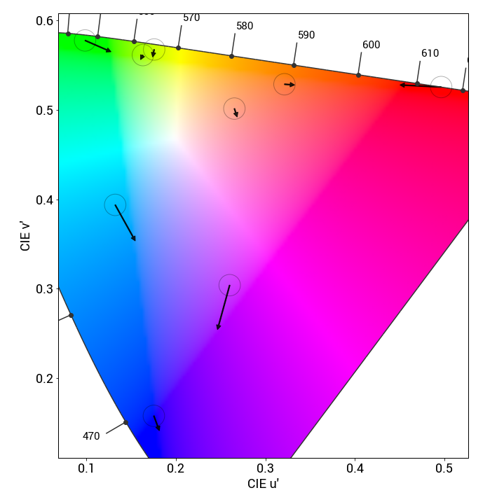

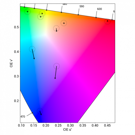

Color fidelity measurements
Crosscall Action-X5, color fidelity at 1000 lux in the sRGB color space
Crosscall Action-X5, color fidelity at 1000 lux in the DCI-P3 color space
Each arrow represents the color difference between a target color model (arrow base) and its actual measurement (arrowhead). The longer the arrow, the more visible the color difference. If the arrow stays inside the circle, the color difference will only be visible to trained eyes.

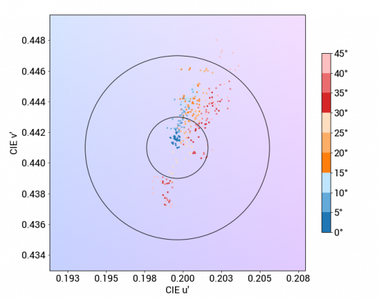

Behavior of the color on the corner
This graph shows the shift of color when the screen is tilted. Each point represents a measurement with a particular angle. The points inside the inner circle show no color change in the corner; those between the inner and outer circle have shifts that only trained experts will see; but those who fall outside the outer circle are noted.
Color change on the corner

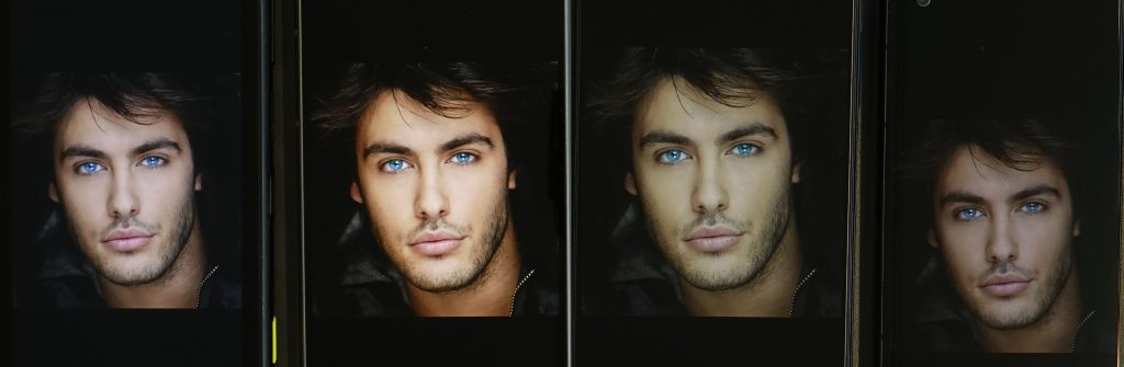

Rendering SDR video in a low light environment (0 lux).
Clockwise from top left: Crosscall Action-X5, Fairphone 4, Asus Zenfone 8, Nokia 8.3

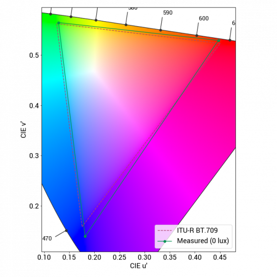

Range coverage for video content
Primary colors are measured in both HDR10 and SDR. The extracted color gamut shows the extent of the color area that the device can render. To respect the artistic intent, the measured gamut should match the main color space of each video.

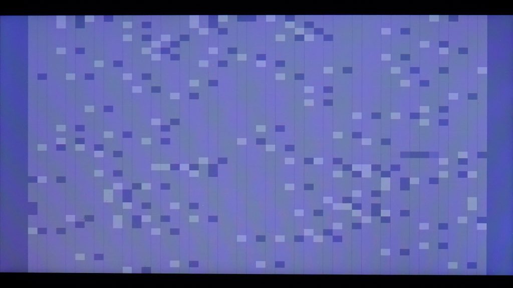

The video frame drops
These long exposure photos present the number of frame irregularities in a 30 second video. A good performance shows a regular pattern (a flat gray image or a drop-down pattern).

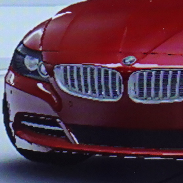

Alias ​​(foreground)
Crosscall Action-X5
